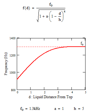

Did you try plotting it just to get an idea of the shape of the curve? Assign some arbitrary values to the constants and plot fd versus d. Note that the way the given function is defined the fd is in the denominator on the left hand side. So if you rearrange to isolate it you'll get something of the form:
$$f(d) = \frac{f_o}{\sqrt{1 + a\left(1 - \frac{d}{h} \right)^4 }}$$
where fo, a, and h are chosen suitably.
I can't see how your spreadsheet does its calculations, but your results are certainly different from what I see plotting a function of the form I showed in my previous post. Here's a snip from a Mathcad worksheet:
The constants fo, a, and h were chosen arbitrarily just to get a feel for the form of the function.
View attachment 98231The constants fo, a, and h were chosen arbitrarily just to get a feel for the form of the function.
I was graphing fd and d
