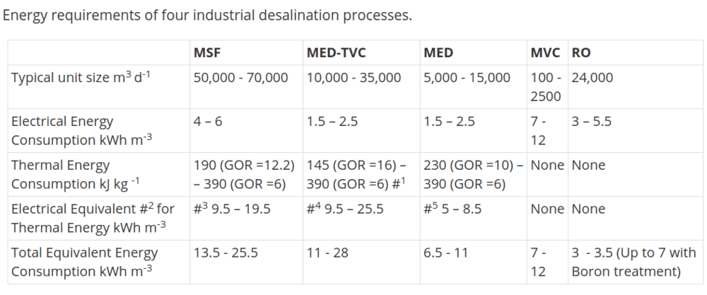

This source gives a table.
Table of energy requirements for four industrial desalination processes (MSF, MED-TVC, MED, MVC, RO), listing typical unit size, electrical and thermal energy consumption, and total equivalent energy consumption in kWh per cubic metre.
MSF=multi stage flash
MED-TVC=Multiple Effect Distillation with Thermal Vapour Compression
MED=Multiple Effect Distillation
RO=reverse osmosis
RO appears to be the lowest. However the RO number does not include the thermal energy needed to produce the electricity. In the case of nuclear, multiply by 3, so that RO takes 9-10.5.
In rough numbers, it sounds like about roughly equal. Use nuclear heat to evaporate water directly, or use it to generate electricity and use the electric for RO desalinization.
