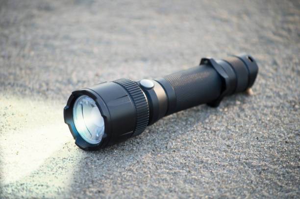

Why would'nt I?
What I am saying is that theoretically, if the speed if light could be increased by a factor of oh I dunno... a zillion, then you would not need to generate as many to provide rocket-level thrust.
https://media.istockphoto.com/photo...=UleG3UwGPIAECkspNn8-OvmDabi7kTR2HrKFGulAXgU=

The problem is that even if you ignore Relativity's limit of c and use strictly Newtonian physics, increasing the speed of photon by a factor of a zillion involves increasing its energy by a zillion squared. If you were worried about nuking things in the exhaust path before, you just made it a lot worse.
The momentum of the exhaust is proportional to the its mass and velocity. So increasing an exhaust particle's speed by a factor of ten gives it 10 times the momentum. So you could get the same total momentum with 1/10 as many particles. However, the KE of those particles go up by the square of their velocity; increasing any given particle's velocity by a factor of ten increases its energy by a factor of 100. So 1/10 as many particles moving 10 times faster take 10 times the energy to get up to speed, and have 10 times the kinetic energy while not actually having any more total momentum.
While increasing the exhaust velocity increases the efficiency in terms of the amount of reaction mass you need to carry in order to reach a given speed, it has the opposite effect on the efficiency in producing thrust in terms of joules of energy expended.
Assume you have a 1 kg "payload" you want to get up to speed and a set energy budget of 10 joules to work with. That 10 joules can be used to either expel 10 kg of reaction mass at a speed of 1.414 m/s or a 1 kg reaction mass at 4.47 m/s.
in the first case, the delta v of the payload = 4.264 m/s
in the second case, it equals 3.16 m/s
For the same energy budget* you get a better result tossing a larger mass out slower than smaller mass faster.
When you expel reaction mass for a rocket, the energy doing so is split between the rocket and the reaction mass. The higher the velocity the exhaust has, the larger the fraction of this energy it carries away. *With a chemical rocket, the fuel and reaction mass are one and the same. Adding more fuel adds both more reaction mass and at the same time increases your energy budget.
