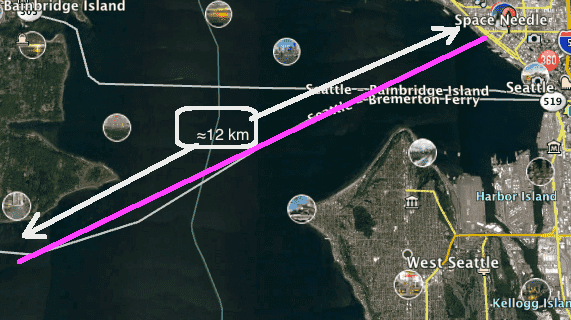

OmCheeto said:
My calculations tell me that the Seattle to Bremerton ferry will sink about 40 feet by the time it makes it's right turn. Of course, you would have to be watching from water level. Seems like that should be visible with binoculars, or better yet, a camera with a healthy zoom.
Someone at stackexchange described the experiment. It's the first response to someone's question; "How high up do you have to go before you can sense the curve of the earth?"
I'll have to remember to try and recreate the experiment this summer.

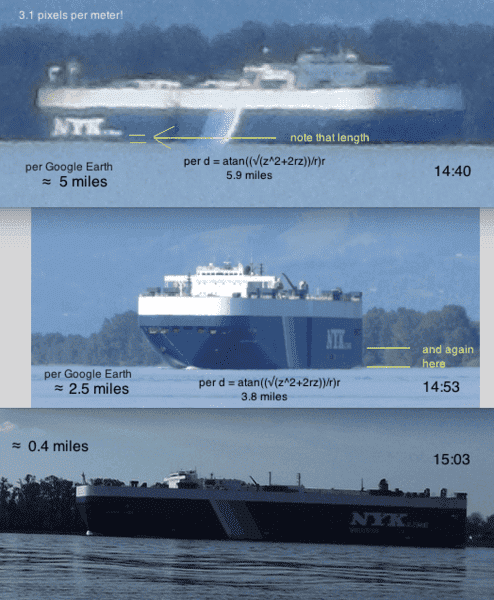

Collected some data yesterday, and today I did the maths.
Visually, even at 5 miles, it's obvious.
Guessing that my maths is a bit off (distance of 2.5 miles ≠ 3.8 miles) because of resolution problems.
Regarding the equation in the image:
d = atan((√(z^2+2rz))/r)r
d = how far you have to walk to see something of height z disappear over the horizon.
r = radius of Earth​
Camera was positioned ≈ 0.8 meter above the water line.
