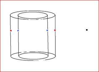

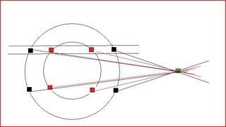

Lets consider a hollow sphere with charge +q and than a larger hollow sphere that encloses it with -q, so two spheres one inside the other. Now we use draw an even larger Gaussian sphere that encloses both of these,
∫EdA = Qinclosed/ ∈_0
the total enclosed charge is +q + -q = 0
so
∫EdA = 0
E ∫dA = E (area of sphere) =0
so the Electric field must be zero, but how could that be? So any test charge (black square in diagram) placed outside the two sphere will experience absolutely no electric force? Wouldn't it experience some force from the -q sphere since it is on the outside and always closer to any test charge?
No it wouldn't. As you calculated.
To grasp this: where is the charge sitting on the outer sphere ?
By the way: your reasoning doesn't take into account that the negative charge 'on the left' is further away from the test charge ...

I still don't get it, how would that effect it? According to Coulombs law a closer charge feels the force stronger,

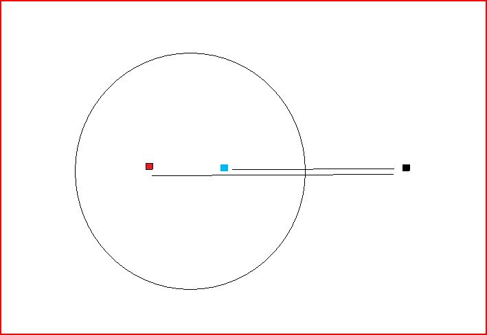

what if we consider a situation where that issue is not present, such as a dipole?
The test charge (black) should feel a force on it since it is closer to the blue(+) charge but Gauss law says 0, My dilemma is still the same.
In this case you misinterpret Gauss law: there is no spherical symmetry so you can't just take ##\vec E## out of the integral: it does indeed not have the same value on every point of the Gaussian surface.
Oh so in the integral some EdA will be positive and some negative so it will be a total of 0,

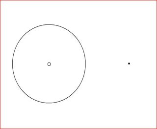

Lets go back to the two sphere, you said that "the negative charge 'on the left' is further away from the test charge"

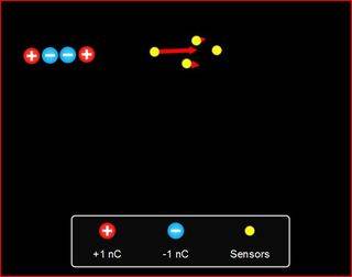

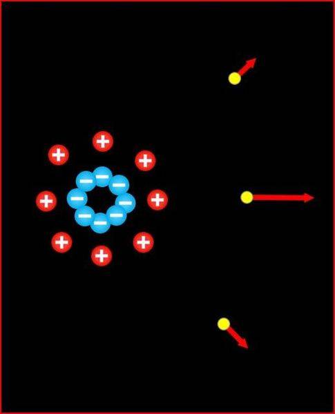

I used a phet simulation for that
and it showed that it still felt an electric field from the closest (positive) charge
I don't see two spheres anywhere. There are plenty proofs of Gauss' law around. A phet quadrupole simulation is no proof of the contrary.

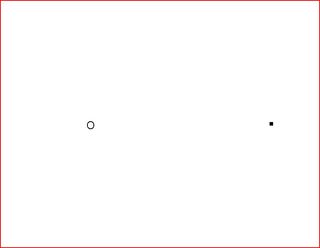

I know, I only selected those 4 as a slice of the spheres at the diameter to test what you said
"your reasoning doesn't take into account that the negative charge 'on the left' is further away from the test charge"
If I add more and keep on making it look like spheres the results don't change

Are you using https://phet.colorado.edu/sims/html/charges-and-fields/latest/charges-and-fields_en.html ?
Have you viewed it using the "Electric Field" checkbox (showing magnitude [via brightness])... not just the sensors?
What happens further away from the centers?
Note that if your charged "spheres" are not placed precisely, the discrepancies will be more evident if you are not far enough away.

As you move further away E decreases, I would expect that anyway even if E was not supposed to be 0 everywhere
That tool is helpful to visualize the flux but it does not help me understand it.

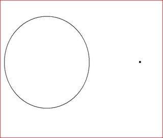

To check that here is what I did, I take a slice of the sphere,
--- = distance = d
[] = test charge
1 2 3 4
Force from 1 = kq/ (4d)2
F_2 = -kq/ (3d)(4d)2
F_3 = -kq/ (2d)(4d)2
F_4 = kq/ (d)(4d)2
kq/d2 [ (1/16) - (1/9) - (1/4) + (1/1) ] = kq/d ( .7) , not zero
So from this I concluded that the points on the sphere that are further from the text charge would not balance out the force felt from the charge on the outer sphere closest to the test charge.

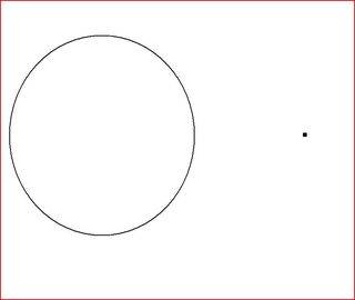

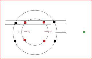

lets consider the spheres as a stack of slices, as in an integral. Each point on each slice has one corresponding point bellow, and the forces of the test charge (green) will cancel in the Y direction, so only the X components will act,
So we can represent the forces as this
And If the spheres are just a stack of slices consisting of 4 points like the ones I drew
The total force from each slice is not zero, the sum of all these slices would also not be zero.

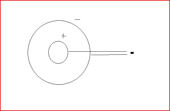

$$\vec{E}(\vec{r})=E_r(r) \frac{\vec{r}}{r}, \quad r=|\vec{r}|.$$
To get the component in radial direction ##E_r(r)## in Gauss's Law you can now choose a spherical shell around the origin of radius ##R## with ##R## varying to get ##E_r(R)## at each distance from the center. The surface normal vector ##\mathrm{d}^2 \vec{A}=R^2 \vec{r}/r \sin \vartheta \mathrm{d} \vartheta \mathrm{d} \varphi## in the usual spherical coordinates. Thus your surface integral gives
$$\int \mathrm{d}^2 \vec{A} \cdot \vec{E}=\int_0^{2 \pi} \mathrm{d} \varphi \int_0^{\pi} \mathrm{d} \vartheta R^2 \sin \vartheta E_r(R) = 4 \pi R^2 E_r(R).$$
Now let's call the radius of the inner sphere ##a## and the radius of the outer sphere ##b##. You have to read off the charge enclosed by the sphere with radius ##R##, and thus you have to distinguish just three cases:
(1) ##0 \leq R<a##
Then there is no charge inside the sphere and thus according to Gauss's Law
$$4 \pi R^2 E_r(R)=0 \; \Rightarrow \; E_r(R)=0 \quad \text{for} \quad 0 \leq R < a.$$
(2) ##a<R<b##
Then there's the full positive charge ##Q## inside the sphere and thus
$$4 \pi R^2 E_r(R)=\frac{Q}{\epsilon} \; \Rightarrow \; E_r(R)=\frac{Q}{4 \pi R^2} \quad \text{for} a<R<b,$$
(3) ##R>b##
Then the total charge is again 0 and thus again
$$E_r(R)=0 \quad \text{for} \quad R>b.$$
This means you have a Coulomb field for ##a<R<b## and otherwise no field at all.

In post #11 you pick 8 points, but forget a few things:
  • the black charges are smaller than the red
  • there are no red charges 'above' the radius of the inner shell
so looking at it this way gets you nowhere. The good news is you only have to look at one of the two shells: if that gives a radial ##|\vec E| = {1\over 4\pi\epsilon_0} {Q\over r^2} ## you're done (because the other gives the same but with a minus sign).

But if I consider a point radially on the right outside of the two charges, and then I rotate the two spheres 180 degrees clockwise about their centers at the same time, then the point on the left would be same as the point on the right in the unrotated case. If I look at the two spheres, I wouldn't be able to tell if there was any rotation in the first place.
So shouldn't by symmetry, the E be same at every value on a spherical gaussian surface encapsulating the 2 spheres?
FallenApple said:
Interesting.
How do you know it is symmetrical?

Well its concentic spheres of postive and negative. The only geometric discription is that the positive is so and so distance away from the center and the negative is so and so distance from the center. Left and right has no meaning.
I don't think there is a contradiction. The field is 0 outside. Even though the charges are same in magnitude. The charge on the outer shell is less dense. Giving rise to fields that are equal in strength but opposite in magnitude to the inner shell.
I believe i copy and pasted the boxes, if they are different sizes that is a mistake, they are meant to be the same charge but opposite in magnitude.
So would my representation be valid for 2 cylinders instead? Gauss law also states E=0 outside them and it is the same concept.
