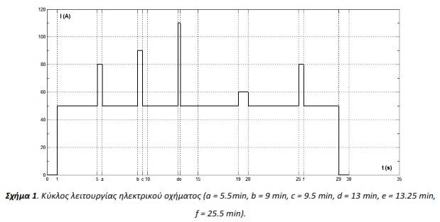

The area under the diagramm is the capacity.Q=I(A)*t(s)
How can I can get the Voltage so tha I get the energy of the battery and capacitor?

Because only current and time are specified, it is not possible to know the voltage of the battery.

I have a chemical battery and a capacitor (over 45(A)).
Can I find the energy of them?
Can I assume V=I*R with R=1ohm?
Because I(A) get straight to 45(A) and we don't have a curve.

This exercise was on last exams.
The only information was the diagramm that is from a electric car with a battery and and a capacitor for acceleration. There is no more information.
That diagram will contain the detail.

That's 50A isn't it? That graph can tell you the net charge into/out of the capacitor. Then use Q = C.V to determine the associated change in voltage, but you do need to know C.
There'll be a graph describing the battery, and you use that to determine the battery voltage.
This is cycle of a functioning electric vehicle [as translated from Greek]
Let's say this is total discharge battery= 117.6 Ah .A usual battery of 12V 120 Ah could present this discharge process. However a 24 V battery could present the same.
It could be one like this:12V/120Ah/115F51 JIS Car batteries, Sealed lead acid batteries -in my opinion.
By the way, I*R it is not the battery voltage-except in short-circuit case-but it is the voltage drop through the battery and so I^2*R it is not the delivery power but the battery losses.
The delivery energy it is ʃV*I*dt .Since in the discharge time interval [up to- let's say 1.8 V from 2.2 V rated] you may consider the delivered voltage as constant and equal to the rated and then the delivered energy will be Vrated*Q.
