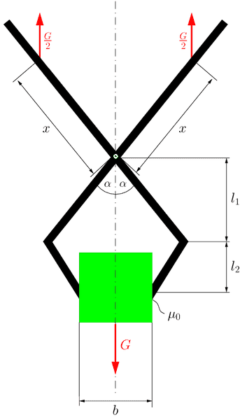

We should get the length x , when the grabber can just hold the box.
I made two moment equations:

Then I put them together into one equation:
And from that equation I found out x:
Unfortunately the result seems to be wrong. Can you please help me? Where I made the mistake?
i think the frictional force balance the wight of the box.we have to give the normal force on the box that give rise to the friction by giving a torque to the grabber

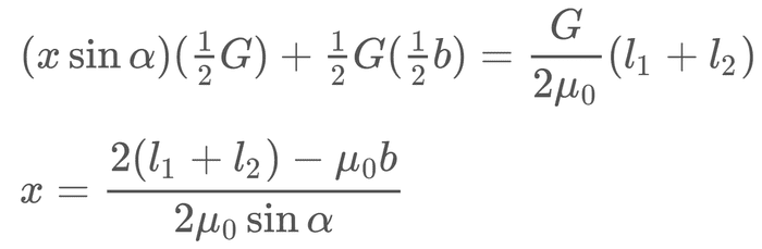

I finally got it. Here is the solution.
Yes,that is the correct answer:smile:
