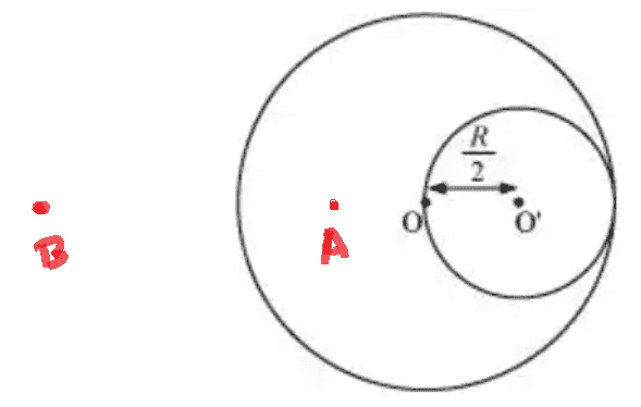

A planet of mass ##M## has a part of it removed as shown in the diagram. Find the gravitational field at point A (which is 1/2 R from O) and point B (which is 2R from surface)
##g=\frac{GM}{r^2}##
##g=\frac{GM}{R^3}r##
##V=-\frac{GM}{r}##
The removed mass is ##\frac{1}{8}M##
My idea is to find ##g## from large sphere then minus it with ##g## from small sphere (because of the removed mass):
##g## at A =
$$\frac{GM}{R^3}\left(\frac{1}{2}R\right)-\frac{G\left(\frac{1}{8}M\right)}{R^2}$$
Is this correct? Thanks

Looks right.
Just remember the gravitational field is a vector.

This is how I calculate gravitational potential at point A:
V at A =
$$-\frac{GM}{R}-\left(-\frac{G\left(\frac{1}{8}M\right)}{R}\right)$$

Sorry, that does not look correct.

No. This is only possible inside a spherical shell.

Is that the formual I need to use? So maybe like this: V at A =
$$V=-\frac{GM(3R^2-(\frac{1}{4}R^2)}{2R^2}-\left(-\frac{G(\frac{1}{8}M}{R}\right)$$
Thanks
This is not dimensionally correct. How did you get it? Maybe your method is correct but not the execution. We can't tell unless you show us what you did.

I googled the formula for potential inside solid sphere but I got the wrong formula. This is the correct one:
$$V=-\frac{GM(3R^2-r^2)}{2R^3}$$
So V at A should be:
$$V=-\frac{GM(3R^2-\frac{1}{4}R^2)}{2R^3}-\left(-\frac{G(\frac{1}{8}M)}{R}\right)$$
Is that correct? Thanks
How do you know that this formula that you googled is correct? In post #4
songoku said:
When calculating potential gravity at point D due to large sphere, is it correct to use R as the distance since the potential gravity inside the sphere is constant and the same as at the surface?
you seem to think that the potential inside the sphere is constant and the same as at the surface. The formula you found says that the potential is not constant inside and that it is equal to the potential at the surface only at the center. Which is correct and why?
I think that the intent here is for you to do the derivation yourself, not google it. Then you will have learned something other than "I can always google the answer." The googled answer should be a check whether you did it right.
The problem is asking you to find the gravitational field at a point inside the larger sphere and outside the smaller one (point A) and also outside both spheres at point B which you haven't done so far. Knowing the expressions for the fields, the idea then is to find the potential at points inside and outside by doing the appropriate line integrals.

##g## at B:
$$g_B=\frac{GM}{9R^2}-\frac{G(\frac{1}{8}M)}{\frac{49}{4}R^2}=\frac{89}{882}\frac{GM}{R^2}$$
V at A:
$$V_A=-\frac{GM(3R^2-\frac{1}{4}R^2)}{2R^3}-\left(-\frac{G(\frac{1}{8}M)}{R}\right)$$
V at B:
$$V_B=-\frac{GM}{3R}-\left(-\frac{G(\frac{1}{8}M)}{\frac{7}{2}R}\right)$$
Is the idea correct? Thanks

Without doing the math myself it seems all right but you can check it by deriving the field from the potential and see if they match.

##g## at A =
$$\frac{GM}{R^3}\left(\frac{1}{2}R\right)-\frac{G\left(\frac{1}{8}M\right)}{R^2}=\frac{3}{8}\frac{GM}{R^2}$$
V at A:
$$V_A=-\frac{GM(3R^2-\frac{1}{4}R^2)}{2R^3}-\left(-\frac{G(\frac{1}{8}M)}{R}\right)=-\frac{5}{4}\frac{GM}{R}$$
Then:
$$-\frac{dV_A}{dR}=\frac{5}{4}\frac{GM}{R^2}$$
which is not the same as ##g_A##, but I can't find where I went wrong. Where is my mistake? Thanks

Differentiating wrt R is not going to give the field at A. You want how the potential changes if you move a little from A, but R is not a measure of displacement from A. If you change R the whole setup changes.

I understand. I am just crazy to take derivative wrt R because R is constant.
Thank you very much for all the help and explanation haruspex, bob012345, kuruman, Orodruin
