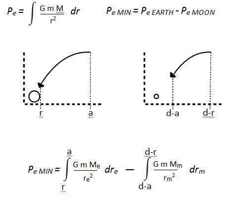

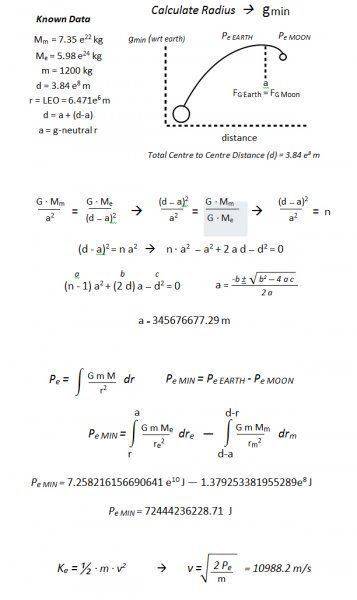

How about this ? I put it in an image because it's quicker... The whole deal with factoring in the moon is really confusing me because this is out of my league, but I'm trying to comprehend it... I think this is getting closer but if I got this wrong still I'm really lost.
The LEO variable r is because that's the starting distance where the object need to be going the initial velocity by in launch... I'm not factoring the ground into it because I figured I would separate the launch from the lunar injection shot since it's going to depend on thrust forces and variable mass with loss of fuel etc...
So if I launch from 6.371e6 m, by 6.471e6 m, I must be traveling the calculated initial velocity, this gives the object 100 km to accelerate the object to the initial velocity, while getting the mass down to 1200 kg, and also set it in the right direction.
That's why I think this should be the lower bound with respect to Earth for the potential energy, and the distance minus this LEO radius for the upper bound of the potential energy with respect to the moon?
But again, incorporating the moon is where I'm brain farting. The closer the object gets to the moon, the more the moon attracts it, even though the Earth is attracting it the other way more.
So the first integral takes the PE with respect to Earth from falling from the a distance to LEO without the moon in the picture at all. Then I subtract the potential energy with respect to falling to the moon between said distance integrated, but from the moons frame of reference.
I think this is right, because subtracting the work the moon does pulling the craft gives the initial work required without the help of the moon, and without subtracting the work the moon does, the initial velocity would be too fast because it's neglecting the help the moon is giving right?

I don't understand why you are doing any integration. In post #7 you gave a correct quadratic equation for determining h. You went on to provide correct expressions in terms of h for the PE changes, both wrt Earth and wrt Moon, as the object goes from Earth's surface to h. Why don't you just add those up for the total PE change and substitute in the value of h?
How do you mean? I think that's what I did by subtracting the integral wrt Earth from the integral wrt moon... The total PE of either system requires an integral? and in post 7 I had the integral expanded which you mentioned that the integral for PE with respect to the moon was correct.
I've basically subtracted the PE of a towards to the moon without earth...
r max = the total center to center distance minus the LEO radius at Earth
to
r min = total center to center distance minus quadratic height
From the PE of a fall to Earth without the moon...
r max = the quadratic height
to
r min = the LEO radius at Earth
Which gave me the left over PE being the KE required to get from LEO at Earth to the quadratic height in the direction towards the moon...
I'm pretty sure this is right because the moon PE that I subtracted will be made up along the way by the gravitational work that the moon does pulling the object as it moves in the moon's direction.
In post #7 you wrote
julianwitkowski said:
To get h in FG earth = FG moon
I did the algebra to get the quadratic on h... ##\frac{GM_e}{h^2} = \frac{GM_m}{(d-h)^2}## which was simple enough...
So then If I understand correctly, ##\frac{-GmM_e}{h} - \frac{-GmM_e}{n}## is the PE wrt the Earth on the object between these distances in the denominators?
##\frac{-GmM_m}{d-h} - \frac{-GmM_m}{d-n}## Would be the PE in the craft wrt the moon?
Up to this point, you made no mention of performing any integrals, so I presumed you were using the standard formula for gravitational PE. Yes, you can get it by integrating the force formula, but it's a very standard result.
From this point, you can get the answer without any further integration, agreed?
I believe that ##\frac{-GmM_e}{h} - \frac{-GmM_e}{n}## is the integral expansion of ##\int \frac{GmM_e}{r^2}dr## which the interval max = h, and min = n...
And that ##\frac{-GmM_m}{d-h} - \frac{-GmM_m}{d-n}## is the integral expansion of ##\int \frac{GmM_m}{r^2}dr## for the interval max = d-h, and min = d-n.
Therefore, ##\int \frac{GmM_e}{r_e^2}dr_e## - ##\int \frac{GmM_m}{r_m^2}dr_m## with the specified bounds should be equivalent to the required KE to get from n to h...

If you square the denominator in those integrands I agree.
I'll try once more to explain how you've confused me.
In post #7 you quoted the PE formulae without any mention of integration. That's perfectly fine because it is a standard result. You then went on to discuss integration as though this was a later step in the algebra, but you did not need any more integration. You just had to add together the two ##\Delta##PE terms you already had. mfb made the same comment.
Moreover, you went on to write in post #7:
##\frac{-GmM_e}{h} + \frac{-GmM_m}{d-h} ##which is the value of PE at the height of d to d-h​
Now, it's not clear what you meant by that. Why did you write "of d to d-h"? Why not just "at height h"?
Anyway, your working in post #10 looks ok. I advise people against substituting in numbers until the final step, though, for a whole set of reasons.
I have not checked the numbers.
I'm sorry, in respect to ##\frac{-GmM_e}{h} + \frac{-GmM_m}{d-h} ## I don't know what I was talking about either, I think I was hoping that the 2 integrals that work would simplify to that but this is certainly bonkers, I agree. Part of my problem is finding the right words to express what it is I mean, which is what I'm working on. Thanks for all your help, really appreciate this!
