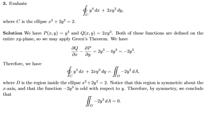

Question 1) Suppose I tried to convert ##\int \int_c {-2y^3} dA## into polar coordinates. What would the limits be? I know that ##x = rcos(\theta), y = rsin(\theta)## but the two rs are different (unlike in a circle).
Q2) Regarding the picture, it says "Notice that this region is symmetric about..."). I was never taught this in school and as a result I have a few questions: Is there a trick for memorizing this? Is there a simple proof? Are there any other examples where I could use this "symmetry trick"? And finally, it seems that the trick is only dependent on ##-2y^3## and not on the shape of the ellipse, right?

Rewrite the ellipse in standard form:$$
\frac {x^2} 2 + \frac{y^2} 1 = 1$$This suggests the polar-like substitution$$
x = \sqrt 2 r \cos\theta,~~y= r \sin\theta$$Now you can let ##r## vary from ##0## to ##1## and ##\theta## from ##0## to ##2\pi##. And don't forget the proper ##dA##.
Wrong. The shape of the ellipse being symmetric is why the integral is zero with an odd integrand in ##y##.
