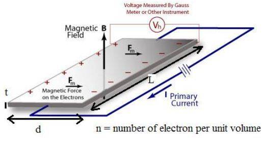

[See the figure attached]
a) Find the relation between velocity of electron v and current I.
b) Because of the magnetic force on the electron they move at the edge of
conductor as shown in the figure and create a electrostatic force that oppomagnetostatic force. Find the expression for electrostatic force and magnetforce when they balance each other.
c) At equilibrium find an expression for Hall voltage V
in terms of magneelectron’s velocity v and width d.
H
Now, in a Hall-effect experiment, a current of 3.0 A sent lengthwise through a co1.0 cm wide, 4.0 cm long, and 10 mm thick produces a transverse (across the wpotential difference of 10 mV when a magnetic field of 1.5 T is passed perpendihrough the thickness of the conductor. From these data, find the number of elper unit volume of the conductor.

Hall Voltage seems different from the normal textbook voltage problems that I have encountered. So, I couldn't make some satisfactory advancement.
