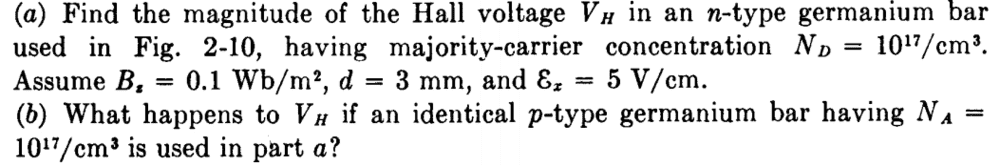

a. Find the magnitude of the Hall voltage VH in an n-type germanium bar used in fig, having majority-carrier concentration ND = 10^17 /cm^3. Assume Bz=0.1 Wb/m^2, d=3 mm, Ex=5V/cm.
b. What happens to VH if an identical p-type germanium bar having NA=10^17/cm^3 is used in part a?

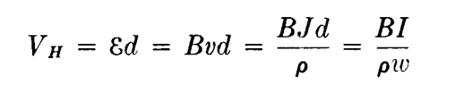

##V_H = Ed=Bvd = \frac{BJd} {\rho w} ##

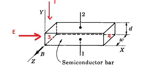

The magnetic field is in the +ve Z-direction, the electric field is in the +ve X-direction, the current will be in -ve Y direction.
There are many equations to find the hall voltages ##V_H = Ed=Bvd = \frac{BJd} {\rho w} ##. But i find the equation ##V_H = Ed## to solve and other parameters are not much of use.
a. n-type 4 will be more negative than 3 and ##V_H = 5*0.3V = 1.5V##
b. p-type 4 will be more positive than 3 and ##V_H = 5*0.3V = 1.5V##
Is the solution correct, or missing something?
No I don't think it is correct. The E-field in the x direction ##E_x=5V/cm## is responsible for creating the current density ##J=\sigma E_x## according to Ohm's law.
It is the E-field in the y-direction ##E_y=Bv## that creates the hall voltage.

The interaction of the current flow and B field creates a Hall voltage that is perpendicular to both, think Lorentz force. The problem statement specifies the direction of both current direction, X-axis, and B-field direction, Z axis. This leave only the Y axis for the Hall voltage. Note that the Terminals "1" and "2" (sense terminals) are in the Y dimension. (But that graph sure shows an unusual axes orientation.)

I don't understand where you disagree with me. We both say that the current is in the x-axis and that the hall voltage is in the y-axis. The way the OP did the calculation implies that the hall voltage is along the x-axis.

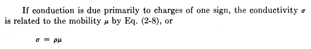

If conduction primarily due to charges of one sign, the conductivity ##\sigma## is related to mobility ##\mu## by
##\sigma = \mu \rho## -> eq4
substitute in eq3 to give
##V_H = \frac{B\mu E_x} {w} ## -> eq5
Now i do not know the value of ##\mu##. Is the above derivation correct? Can i assume its value at 300K which is a standard value i assume.

I feel there is something wrong regarding the ##w## in eq(3). As far as I know $$V_H=Bvd, J=\rho v\Rightarrow V_H=\frac{BJd}{\rho}$$ so I really don't see how you get that ##w## there. Is this equation $$V_H=\frac{BJd}{\rho w}$$ taken straight from the book?
I am really confused with all these equations
Yes it is the current I not the J the current density.
Ah this settles it, yes the book is right (and I was right too in post #10). It is $$I=JS=Jdw$$ that's how the last equality is explained. (##S## is the cross section of the semiconductor ##S=dw## according to the figure provided).

The correct (eq3) is $$V_H=\frac{B\sigma E_xd}{\rho}$$ and IF $$\sigma=\mu\rho$$ is correct then (eq3) leads to $$V_H=B\mu E_xd$$. I suppose from this last equation you can find the hall voltage, if you know ##\mu## as everything else is given.

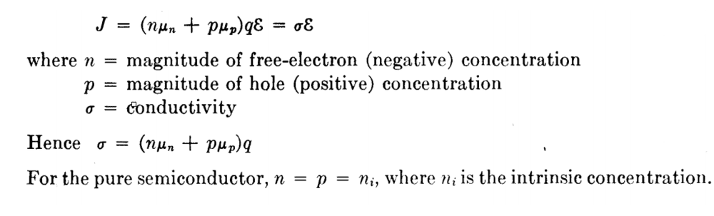

This is how i derived the equations. Generally in some of the previous questions i used to see ##N_D## units as ##atoms/cm^3##
Ok i see. The only problem i see is whether the ##\rho## in this equation ##\sigma=\rho\mu## is the same quantity as the ##\rho## in this equation ##V_H=\frac{B\sigma E_xd}{\rho}##
Also what is q that appears in the equation for ##\sigma## in the image above. Is it the charge of the electron?
It seems that we need ##\mu## to calculate the hall voltage...
