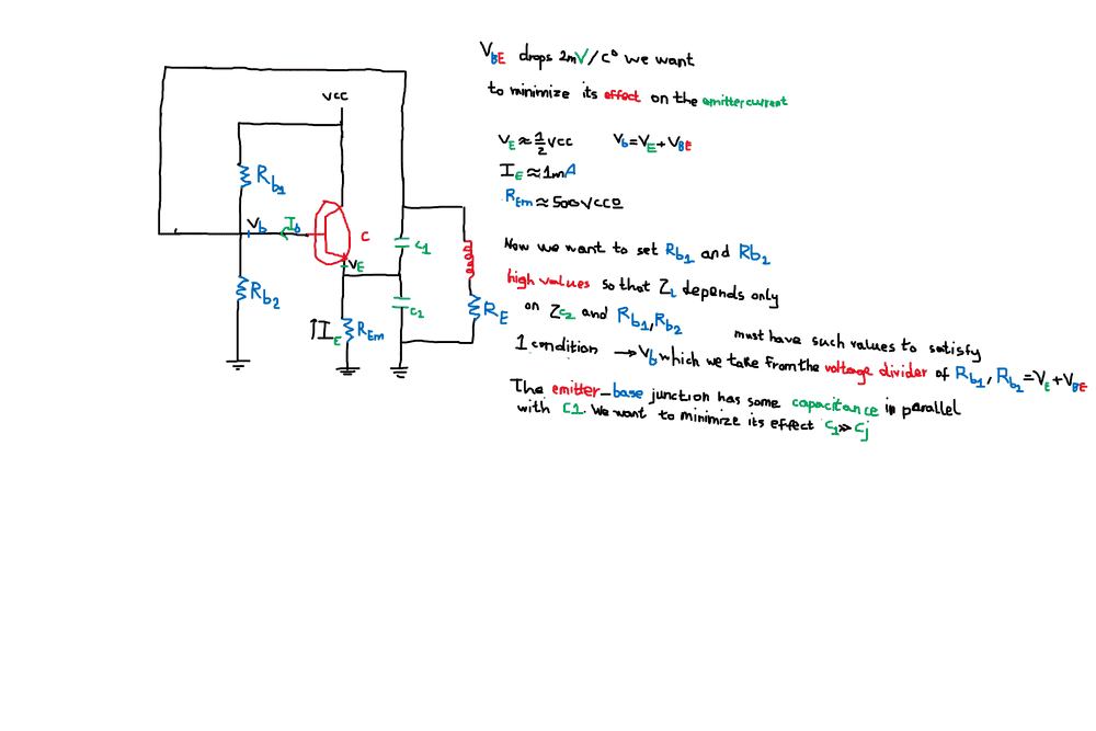

This thread is about if we can add an inductor in series with the emitter resistance in a hartley oscillator.
This is the Colpitts oscillator:
When we design a Colpitts oscillator we must set the value of C1 to be bigger than the parasitic capacitance of the emitter base junction. However in a Hartley oscillator we have an inductive voltage divider and I was wondering if we should put a big inductor (0.1H) in parallel with L1 because Lj = 0 -> L1||Lj = 0;
Adding an inductor in parallel with L1 would change the frequency of the tank circuit. Not to sure about adding an inductor in series with RE. Seems like you add extra impedance to ground which would make the oscillator noisy.
We still need as much capacitance as possible across E-B to swamp out the parasitic capacitance. If it is too high, oscillation will stop due to low gain. If it is too low, the frequency stability will be poor.

I am not asking about this schematic just imagine if you replace C1 and C2 with L1 and L2 and L1 with C1 why don't we add an inductor in series with the Rem
It says when he is talking about the parasitic capacitance of the BE junction that we choose C1 to have such a value that any changes in Cj won't affect the circuit. If we have a Hartley oscillator why don't we put a fairly big inductor in series with L1 (in place of C1) because the total inductance of between base-emitter will be 0 if we don't to make it roughly equal to L1?

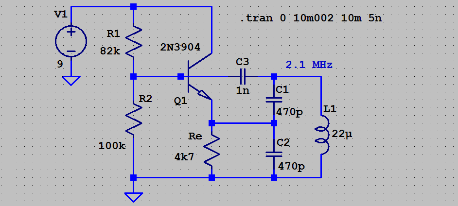

In the OP schematic, L and RE short the base bias to ground.
There seems to be an isolation capacitor missing from the C2 to ground connection, or from the base bias circuit.
Yes, it's not right. I think they meant this configuration:

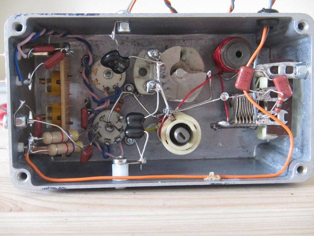

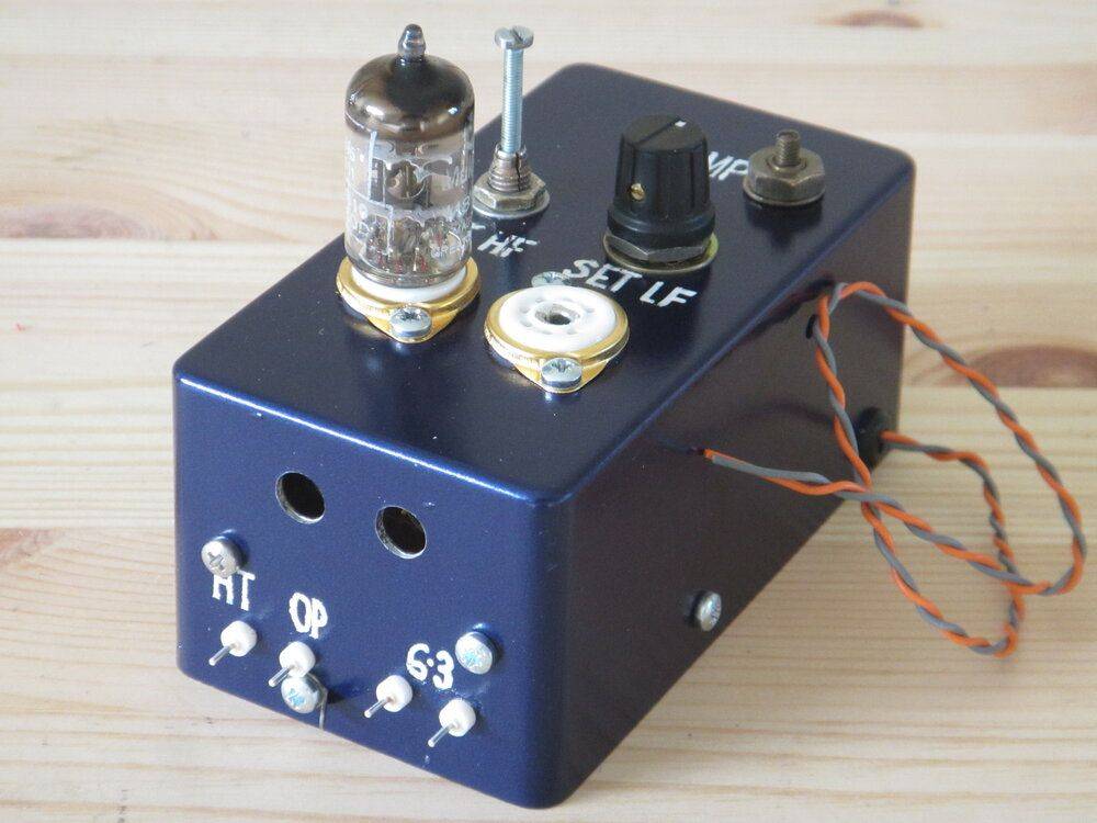

Picture of stable Hartley oscillator using vacuum tube which I recently made.

C3 is just a bypass capacitor for AC signals.

Rb1 and Rb2 is 82k and 100kOhms and Rem = 4.7KOhm with a VCC of 9V
I assume you are referring to the schematic in post #1.
What is the value of RE ?
You do not show a C3 on the schematic in post #1.
Re is the parasitic resistance of the inductor , it is small put it 10 Ohms. And we don't necessarily need a bypass capacitor
10 ohms is a huge of series resistance. I would expect about one ohm.
What you are saying is that the base of the transistor is connected through an inductor with little series resistance to ground. Follow the feedback wire and you will see that the base bias is not being set by Rb1 and Rb2. Go back and check the original source.
Yes I see it too now.We have a very small resistance in parallel with a huge resistance so the small resistance will short the circuit.But in the video he uploads that schematic and using the multimeter it seems to work.
But we know it cannot work because the transistor is biassed off.

When you add C3, the bias works OK and it oscillates as expected.

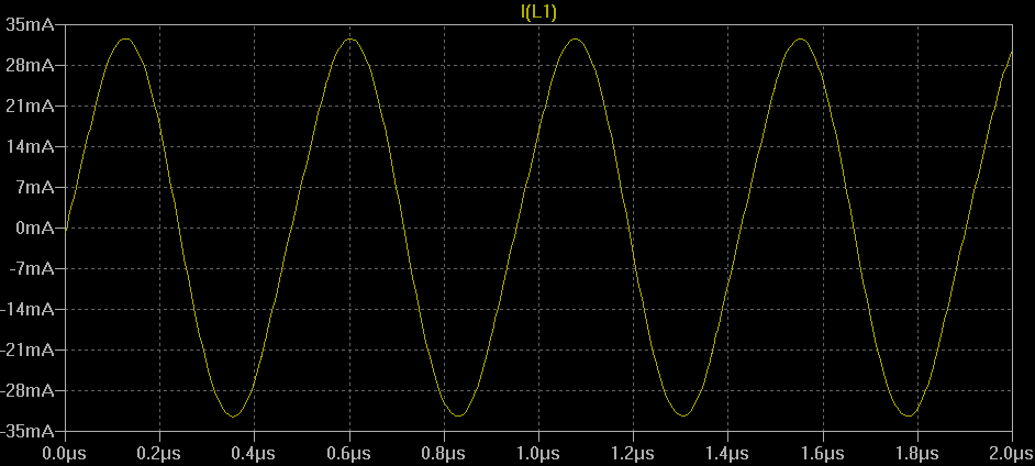

No I didn't. The resonant circuit or "tank" is L in parallel with C1 and C2 in series. One side of L is grounded. The top of L is connected to the base. Half the AC appears across each capacitor, so it acts like a centre tapped "transformer". The emitter drive to the centre tap is effectively doubled to the base.
Spice files attached. To run the .asc file with LTspice, remove the .txt extension that allows me to attach the ascii file to a post. Do the same with the .plt file to get the same traces and colours I get.

The transistor has no bias applied, so it is cut-off and in Class C. No collector current will flow until oscillation starts, then current will flow on positive half cycles. Such oscillators will not start without an intial kick, which might occur due to the switch-on impulse or due to someone touching the circuit.
  • #34
You are correct. Without C3 to float the base voltage the circuit can still maintain oscillation, but it will not start without an initial current pulse in L, or a high voltage applied to the shorted base, neither of which is going to happen in a real implementation of the circuit.
If it could start without C3, the base-emitter junction would then regulate amplitude by entering reverse breakdown at about -5V on each cycle, which is not good for transistor health.

How can 35mA flow through he 4.7k emitter resistor with a supply of 9 volts?
