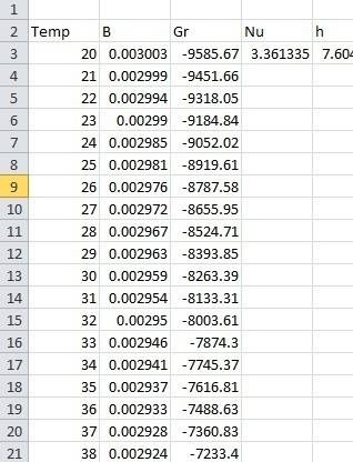

I followed your advice and taken into account decrease in Br and Gr numbers.
Time has now reduced to 7 and a half hours.
The placement of the cylinder on a steel plate is not consistent with the natural convection assumption that the cylinder is levitated. The steel plate is going to interfere with the natural convective flow and slow down the rate of heat transfer. On the other hand, the operation of a fan in the enclosure is very likely to significantly enhance the rate of heat transfer (i.e., increase the heat transfer coefficient). I'm going to try a calculation with a constant heat transfer coefficient of 10 W/m^2K to see if I can confirm your results. Get back to you later.
Chet
OK. With a constant heat transfer coefficient of 10 W/K(m^2), I get about 40 minutes for the temperature to reach 98 C. If the heat transfer coefficient were higher, I would get a lower amount of time.
