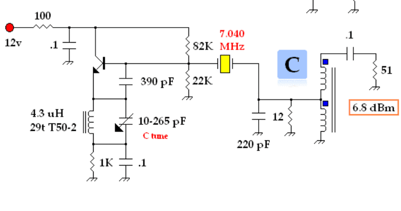

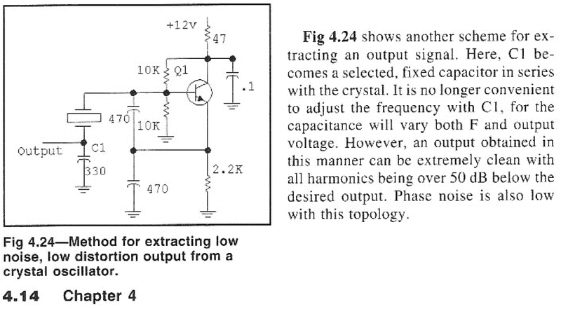

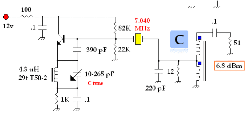

Hello,
Can somebody help, to understand the transistor, what does do 390pF and C(tune), and 4,3µH, they form tank circiuits? and also resistor 1K and capacitor .1, is possible somebody with little words to descirbe how it works please... Thanks.
The 390pF couples energy from the tank to the base and out to the crystal.
The 390pF appears to makes it a common collector Colpitts oscillator.
The base voltage is set to; Vb = 12V * ( 22k / (82k + 22k ) ).
Emitter current is set by the 1k resistor to Ie = ( Vb – Vbe ) / 1k.
The 0.1uF provides very low impedance at RF, much less than the 1k.
The 4.3uH in parallel with 10pF to 265pF is a resonant circuit, like a tank.
The tank circuit will appear as a high impedance at tuned frequency.
The full resonant tank voltage will appear at the emitter.

Hello Sir, thank you for explained, so .1µf is bypass capacitor, i understand everything, just this 390pf(this is common collector colpitts oscillator) i search on internet colpitts oscillator but they don't look like this one, i don't undertsand where is inductor(sorry maybe i am speaking stupid is difficut to understand),
the 4.3µh in parallel with 10pF to 265pF is a resonant circuit ok is good…
sorry i make you tired with this question, this 390pF(i don't understand):headbang:
can you just a litte bit help me, because i understand everything just that no, thanks to you...
of you mean this tank 4.3µf in parallel with 10pF to 265pF resosnace(tank)
For the mode of oscillation of the common emitter Colpitts, see; https://en.wikipedia.org/wiki/Colpitts_oscillator
Your circuit is unusual in that the crystal is being used as a series trap element, driving a low impedance of 12R that is then transformed up to 50 ohm.
Why are you interested in this circuit? Is it homework?

I am reading one book qrphomebuilder called, is not my homework, but i like to learn about rf design radio tuner,and is my hobby,

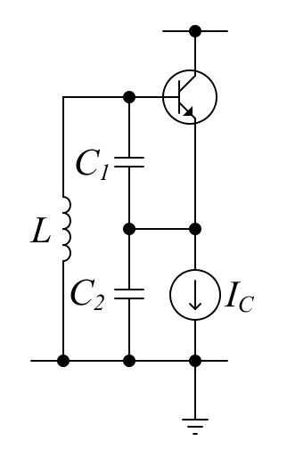

I read a little bit before but colppits oscillator is maked through 2 serie capacitor in paralled with inductor, with active device like now with transistor
Is like 390pF provides feedback
and formula
{displaystyle f_{0}={frac {1}{2pi {sqrt {L{frac {C_{1}C_{2}}{C_{1}+C_{2}}}}}}}_}.png
Is correct?

I cannot see what makes it oscillate.
Where did you find this circuit diagram ?

I told you, i am reading this book qrphomebuilder.pdf, (in the book, this circuits they writte is LOWNOISEOSCILLATOR, more not) and i ask you for help, that is all,.

Hello Michael,
Can you tell us where we can find the book you are reading, qrphomebuilder.pdf? It is an unusual circuit and we hope if we can read the same book we can see how it works.
My research so far found a vacuum tube circuit called an "electron coupled oscillator" that is almost the same. But I can not find good details on how it works for your circuit.
The tank circuit is the 4.3uH coil and the 10-265pF variable capacitor. The 390pF capacitor will change the resonant frequency by some small amount. The main reason for the 390pF capacitor is to feed some of the energy from the tank back to the transistor base so the transistor can oscillate.
I think the complete circuit uses the tank, the 390pF, and the crystal to set the phase shift for the base feedback to allow oscillation.

Hello Tom, here is the link https://nt7s.com/files/QRPHomebuilder.pdf page 268

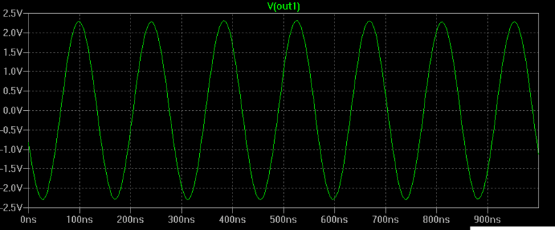

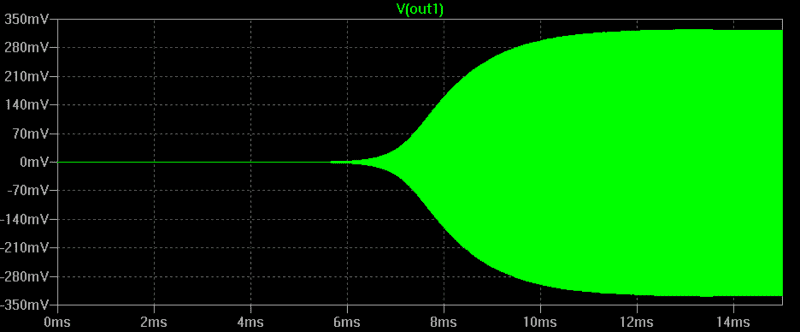

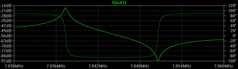

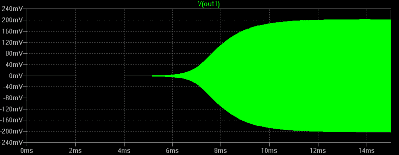

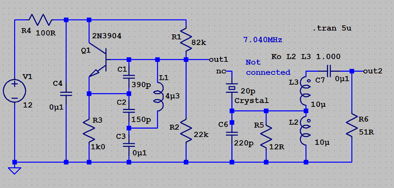

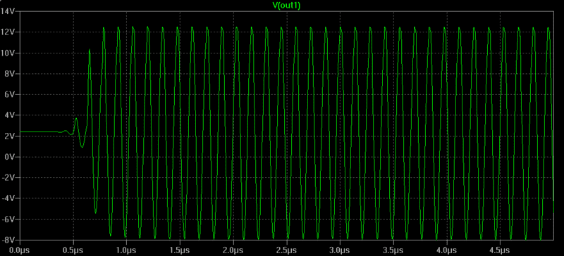

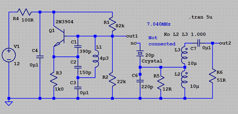

I changed the way the inductor and resistor are connected to the minimum to make it a Colpitts oscillator.
It now self oscillates at about 7.2MHz. I have not yet implemented the crystal trap or output stage.
Thank you sir, for time, thank you for explained…… i understand...so that circuit in the book was wrong?so for the rest everything stay the same, like you explaind #2, 0.1uf stay the same?
The circuit is not yet proven “wrong”.
When I have time I will implement the series crystal and output load, to see what effect it has, and if it makes the original circuit oscillate.

A more complete diagram is on page 270 of 945. The diagram @michael1978 posted is only a partial.
I have the book and circuit. The relevant part of the circuit still has the same tank.
The question comes with how the crystal effects the unusual oscillator. The low impedance output suggests the crystal is being 'held down' at one end, so as to have a greater effect on the base. Also, there is a question, how far does the crystal 'pull' the tank.

I can't say I understand this cct and, as others, would be interested in the EMRFD source, if it gives some explanation. But my 2 cents, FWIW
https://www.physicsforums.com/attachments/227564

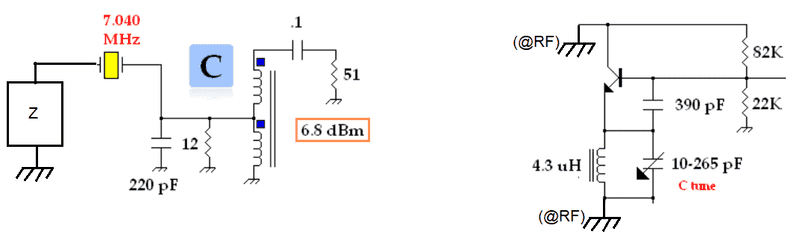

I'm struggling to see this as a Colpitts. It has two capacitors: but they're not in the right place. It's all very well to say that if we move things around a bit we could make it into a Colpitts, but ...? And are the values ok? At different positions of the tuning capacitor?
The whole of the left hand side is a two terminal device as far as the crystal is concerned, so it seems to me it must be a circuit which presents a negative resistance at the operating frequency. (That doesn't actually help me a lot, as I don't know anything about the design of negative resistances around a transistor. The only place I've seen it is with Gunn diodes and op-amp circuits.)
But, I do see references around to instability in emitter followers with a capacitive load. I can't find a detailed treatment of this (and I'm really not up to doing one myself !) but a TI application note for a wideband buffer amp IC makes a fairly unambiguous comment re.emitter follower cct,
Compensation: The three buffer amplifiers are inherently stable in applications with resistive loads and adequate supply bypassing. However, oscillation may occur in cases where a capacitive load of 100 pF or more is present. A series input resistance of 50Ω–300Ω will prevent this oscillation by compensating the negative input-resistance seen as a result of the reflected capacitive load. All source, cathode, or emitter-followers are subject to this phenomenon which is a result of transit time through the active region of the devices.
Whether that helps us here or not, is another question.
We have a parallel LC emitter load. This will become capacitive above its resonant frequency. If that creates a negative resistance input impedance, then the crystal could oscillate at its serial resonant frequency.
If Michael and [Edit: change Anorlunda to Baluncore } are building or simulating this cct, maybe they can see from the data it generates, whether this is happening. It would seem to me that if it were the case, the LC circuit would need to have its nominal resonant frequency below that of the crystal.
If the cct is actually a VFO with a crystal filter on the output, as the QRP Home Builder article seems to suggest, presumably the VFO will continue to oscillate as it is tuned away from the crystal frequency, but the output will drop due to the crystal filter? There may be some "grid dip" effect in the VFO that would show up in the simulation?

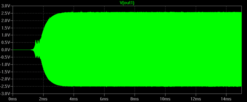

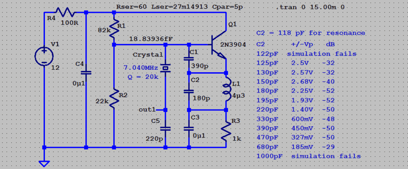

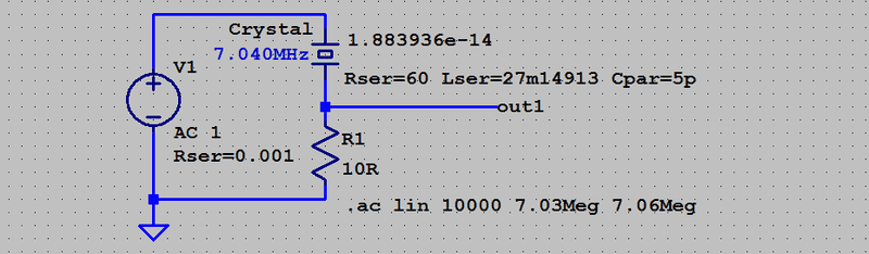

I am satisfied that I have correctly modeled the circuit given. I have found that it does not oscillate, even with a crystal on the output, with higher, lower or matched frequencies between the tank and crystal.
I now question how or why it worked well enough to be written up. Why have a crystal in series with the output? This is an amateur design, so why are there no other similar circuits out there in the literature? Why the weird low-Z output network, followed by the impedance transformer to 50 ohms?
Without other information, I can only assume that the output transformer was coupling back into the tank circuit. That would make it a feedback oscillator.

The frostburg.edu article article explains the circuit as used in the Johnson Radio Viking Ranger Ham radio set.
As the frostburg.edu shows, the B-E capacitor and the E-Gnd capacitor form a voltage divider for feedback. In the OPs circuit the E-Gnd cap is replaced with a tank. In that case, the tank circuit tuning could be rather critical.
Other possibilities; the simulation may use a simplified transistor model without that delay, or the transistor gain could be too low.

michael1978 said:
Hello,
Can somebody help, to understand the transistor, what does do 390pF and C(tune), and 4,3µH, they form tank circiuits? and also resistor 1K and capacitor .1, is possible somebody with little words to descirbe how it works please... Thanks.View attachment 227534
When converting a fundamental oscillator type (like Colpitts) into one mediated by a crystal, they sometimes get developed to exploit the crystal as a narrow filter to deliver an output with very low phase noise, which is a critical feature when the output is to be used in receiver mixer stages.
You are right in that the defining feature of a Colpitts sort is the tuning tank of 2 capacitors in series and an inductor across them.
The variant you have is not quite like that, but that it also has the equivalent circuit of a crystal in series with 220pf and 12 Ohms, all across the resonant part, as in parallel as well.
I can recognize that you are also using LTSpice simulation tool from Linear Technology. I have used this tool before to simulate crystal oscillators. It does require the crystal be substituted by the crystal equivalent circuit.
My first impression of how the circuit operates is that the shunt impedance of the crystal with the 220pf and 12 Ohms, put on the transistor base, will allow the feedback to be effective for oscillation only at the crystal frequency. The very small sample in series with the crystal, taken off the 12Ohms/220pf combination, driving the matching transformer amounts to minimal loading. The signal at this point will be from the resonant ringing in the crystal quartz, in effect a very narrow filter, and the waveform should have very low phase noise.
I am not completely sure of the inductor connection on the variable and 390pF capacitors. Not quite what one would call a "Colpitts" sort.
I have information (PDFs) on most aspects of crystal oscillator design and simulation, and when I can find it, I may come back to this thread and post again.
