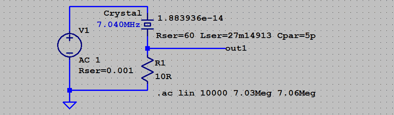

Hello, I with this circuit, an RF oscillator

GTrax said:
It does require the crystal be substituted by the crystal equivalent circuit.
I designed the crystal using spice capacitor parameters. This models the fundamental, but does not model overtones. The code needed to compute crystal equivalent spice capacitor parameters is as follows;
' Crystal specifications wanted.
Fp = 7.040e6 ' crystal parallel resonant frequency, Hz
CL = 20e-12 ' at load capacitance, farads
Q = 20e3 ' crystal Q factor
R1 = 60 ' crystal series resistance, ohms
C0 = 5e-12 ' crystal shunt capacitance, farads
' variables needed for initial temp approximation and final value.
Fs_tmp, Fs ' series resonant frequency, Hz
Wo_tmp, Wo ' angular frequency, rad/sec
C1_tmp, C1 ' crystal motional capacitance
L1 ' crystal motional inductance
' initial computation.
Fs_tmp = Fp
Wo_tmp = Fp * TwoPi
C1_tmp = 1 / ( Q * Wo_tmp * R1 )
Fs = Fp / ( 1 + C1_tmp / ( 2 * ( C0 + CL ) ) )
Wo = TwoPi * Fs
' Refine to final values.
C1 = 1 / ( Q * Wo_tmp * R1 )
L1 = 1 / ( Wo^2 * C1 )
' It generated these capacitor parameters;
Basic capacitance = 18.8393 f F = 0.0188393 pF.
Series inductance = 27.149 mH.
Series resistance = 60.0 ohm.
Parallel capacitance = 5.0 pF.
For a parallel frequency of 7.040 MHz @ Load capacitance = 20 pF
The series frequency is 7.037348 MHz

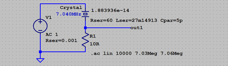

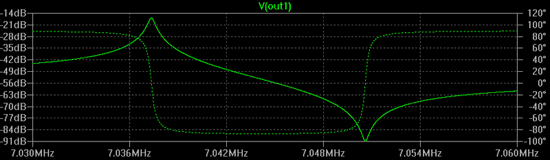

Here is the crystal model and simple output response.
LTspice schematic of a crystal model: AC voltage source V1 with Rser=0.001 feeds a series-RLC crystal branch with Rser=60, Lser=27m14913, Cpar=5p and a 1.883936e-14 basic capacitance, to output node out1, with R1 10R to ground; simulation directive .ac lin 10000 7.03Meg 7.06Meg.
SPICE AC response plot of V(out1) from 7.030 MHz to 7.060 MHz: magnitude in dB (solid green, left axis) peaks near 7.037 MHz then dips sharply near 7.049 MHz; phase in degrees (dashed green, right axis) swings from about +90 to -90 across the same band.
Once simulating the circuit, change the tuning capacitor of the tank, to sweep across the synthetic crystal. Watch the initial transient ringing to see it decay, which implies it has loss not gain.

  • LTspice schematic of a crystal model: AC voltage source V1 with Rser=0.001 feeds a series-RLC crystal branch with Rser=60, Lser=27m14913, Cpar=5p and a 1.883936e-14 basic capacitance, to output node out1, with R1 10R to ground; simulation directive .ac lin 10000 7.03Meg 7.06Meg.
  • SPICE AC response plot of V(out1) from 7.030 MHz to 7.060 MHz: magnitude in dB (solid green, left axis) peaks near 7.037 MHz then dips sharply near 7.049 MHz; phase in degrees (dashed green, right axis) swings from about +90 to -90 across the same band.

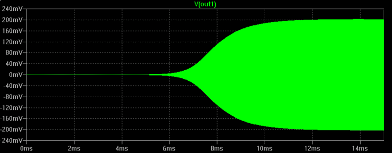

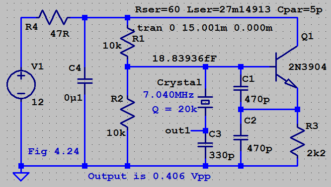

Starting with the circuit from Fig 4.24 of ARRL (2003) “Experimental Methods in RF Design”.
LTspice schematic of a Colpitts crystal oscillator with a 7.040MHz crystal (Q = 20k), two 10k bias resistors, two 470p capacitors, a 330p output capacitor, a 2k2 emitter resistor, and a 2N3904 NPN transistor, labelled Fig 4.24.
A 7MHz crystal with a Q of 20k has a BW of about 7MHz / 20k = 350Hz. That should give an oscillation rise-time of about 1 / 350Hz = 2.86ms. That same crystal model is used here in all simulations.
Here is the output rise-time envelope, which can be seen is slower than expected to start.
Simulated transient plot titled V(out1), green waveform: output voltage rises from 0 mV near 5 ms to a steady ±200 mV envelope by about 12 ms, axes in ms and mV.

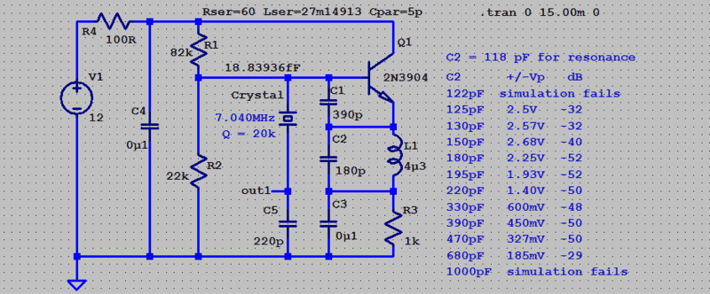

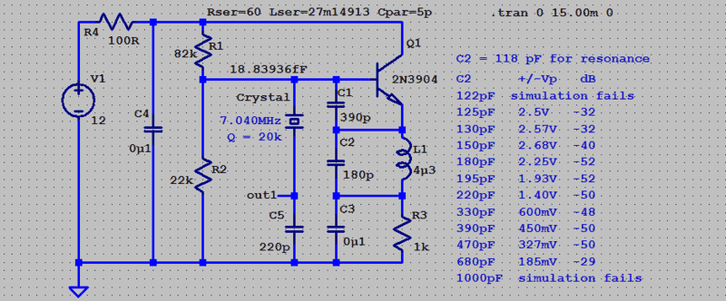

Now we get to the OP's “QRP Homebuilder circuit” which is really a Colpitts crystal oscillator, where the crystal replaces the tuning inductor. The series combination of crystal and output capacitor are an integral part, in parallel with the capacitive divider of the oscillator. Here it is drawn in a way that shows that arrangement more clearly.
Schematic of a crystal oscillator with a 7.040MHz crystal, Q = 20k, in a Colpitts-style arrangement with an NPN transistor Q1 (2N3904), inductor L1 4μH, and capacitors C1 390p, C2 180p, C3 0µ 1, C4 0µ 1, C5 220p; beside it is a table of C2 values with output amplitude and harmonic level in dB.

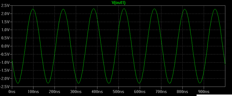

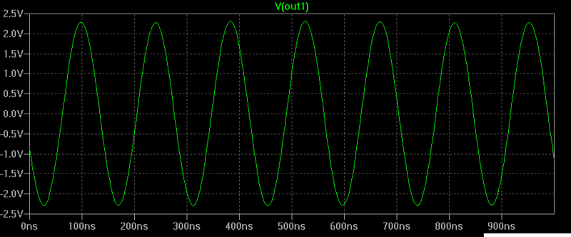

The table of C2 shows half Vpp output amplitude as ±Vp, and the highest harmonic relative to the fundamental. There is a region with good output amplitude and good harmonic suppression.
The simple Colpitts crystal oscillator without an inductor or RFC is slow to start. The addition of the inductance can significantly reduce the rise-time of the oscillation, but that requires the bias current be set separately from the capacitive divider, hence the unusual circuit.
It is important that what we have been calling the 'tank' is NOT made resonant near the crystal frequency. The tank must be tuned on the capacitive, lower frequency side of the crystal frequency. That way it looks like a capacitor at the crystal frequency, which is what reduces the circuit to a crystal oscillator with the Colpitts capacitive divider.
The capacitor output technique can reduce the harmonic content to be 50dB below the fundamental, but don't expect anything more than about 50dB down. Here is the clean output waveform, with C2 = 180 pF.

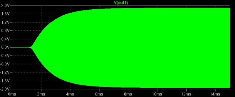

Simulated time-domain plot of V(out1) in green on black, showing a sinusoid from 0 to about 980 ns with amplitude near 2.3 V and a slow envelope rise at the start.

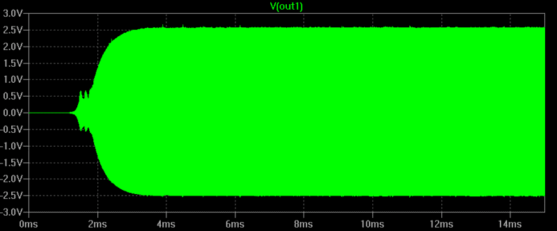

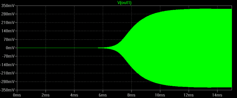

Risetime with C2 = 470pF is;
Simulated transient plot of V(out1) from 0 to about 15 ms, showing a sinusoidal output that stays at zero for roughly 6 ms, then grows to about 330 mV peak in a slow envelope.

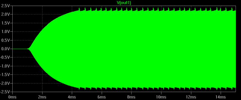

Risetime with C2 = 195pF is;
Simulated transient plot titled V(out1) showing a green oscillation envelope rising from 0V at about 1.3ms to a steady amplitude near ±1.9V by about 8ms, axes from 0ms to 15ms and -2.0V to 2.0V.
Risetime with C2 = 180pF is; ( The saw artefact is a beat between the simulation timestep and the crystal frequency. )
Simulated transient plot of V(out1) in volts against time from 0 to 15 ms, showing a green oscillation envelope rising from 0 V after about 1 ms to about plus and minus 2.2 V by 5 ms and staying roughly steady to 15 ms.
Risetime with C2 = 130pF is; ( Here the artefact shows up earlier in the rise, but then later as whiskers. )
Simulated transient plot titled V(out1) showing a sinusoidal output starting from 0 V near 1.5 ms, growing over roughly 2 ms to a steady amplitude of about ±2.5 V, with x-axis from 0 ms to 14 ms.
It can be seen that this rises significantly faster than was expected.
