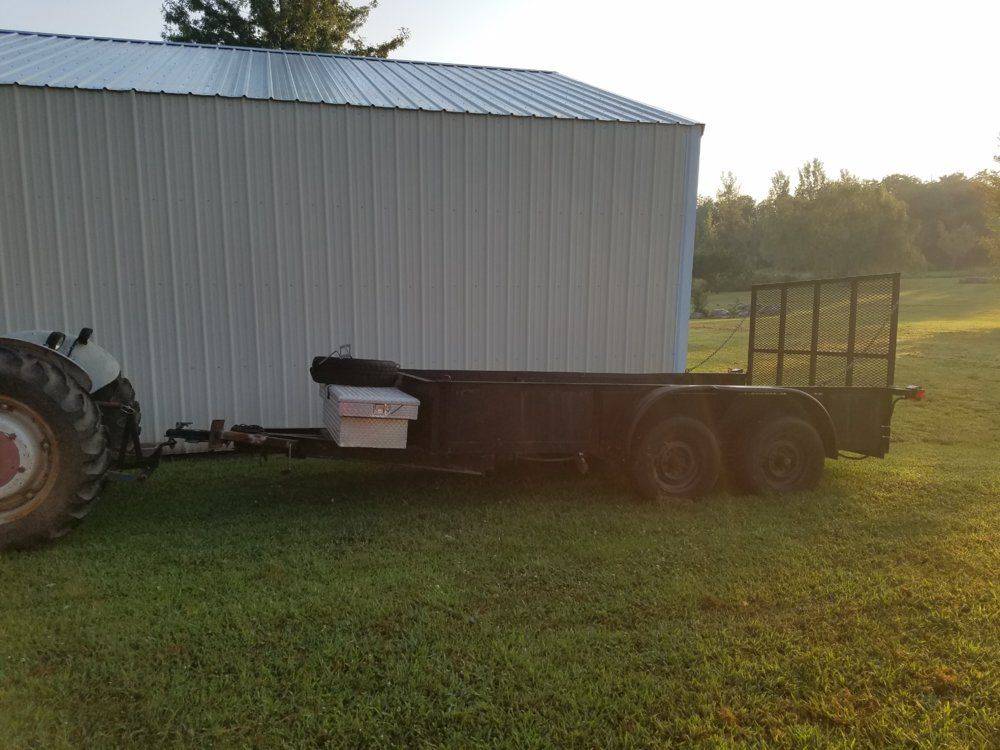

I have a trailer that is aproximately 12 feet by 5 feet wide. I would like to design a way to be able to unload 1 to 2 tons of gravel. (This is not a dump bed). I would also like to be able to unload 1 ton of hot asphalt. One idea is to make one of those hand crank unloaders that you can buy for a pickup bed. But the problem is finding a material as wide as my trailer that won't tear and his heat resistant.

This is the trailer...
The mesh tailgate appears to be for loading and unloading lightweight vehicles like riding lawnmowers. Is it detachable? It doesn't seem consistent with the loads that you are describing...
Yes it is detachable. I made that and put that on there for bringing my riding lawnmower and things in the trailer. The sides are metal and the floor is treated wood.

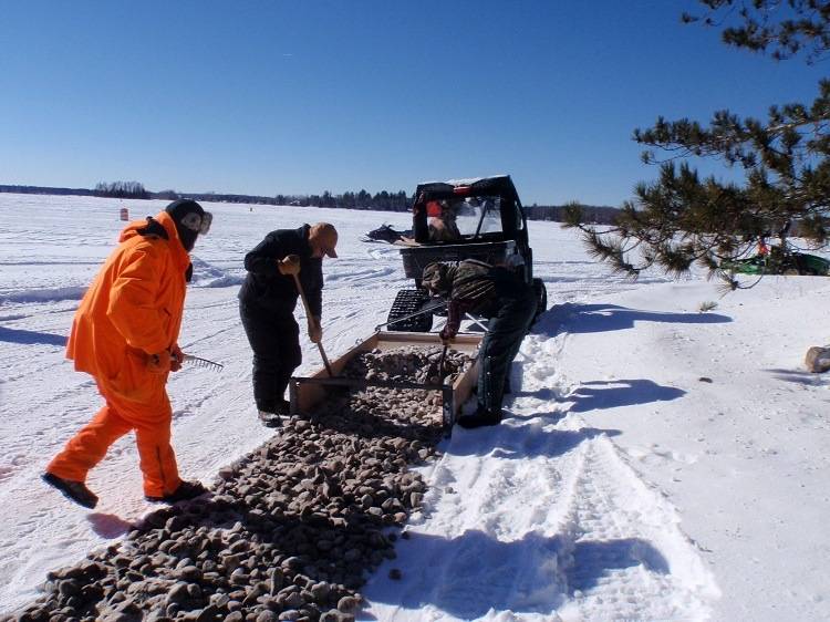

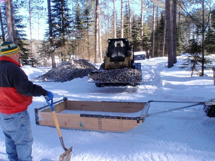

If you line the trailer with UHMW, you may find that there is no need for an unloader. The photo below is a rock sled that I built for distributing rock for improving walleye spawning beds. It holds two full skid steer buckets of rock, and is unloaded by manually pushing the rock out the back while pulling slowly forward.

The sides are 2 X 12's, and at least one rock was too large to fit under the cross bar. The UHMW is so abrasion resistant that it was not damaged by the rocks, even by the largest rock. It is so slippery, especially with some snow on it, that it is almost impossible to stand up in it. It is so tough that we could drag the fully loaded rock sled over boulders, and the UHMW would just flex.
The rock sled in action:
Why was this done? This was a Walleyes For Tomorrow project (http://walleyesfortomorrow.org).
