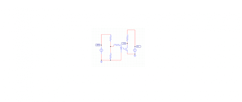

Hello everyone,
I am in need of some help operating the following component:
http://www.vishay.com/docs/83615/il211at.pdf
The 360V and 5V inputs are fixed, as well as the need for 2.5V at the indicated location.
The trouble I'm having is really understanding how the chip works as well as how to have it operating in, I believe it's called, linear mode?
Essentially, I want the 2.5V to change as a function of the 360V changing as well.My current understanding is that the current going through the diode is halved (because of the CTR) and then that current is represented by the transistor behaving as a sort of resistor, which causes a sort of voltage divider behavior. Thanks for any help!

Oh, I'm sorry. I thought i had posted it:
That's not really the proper way to operate that type of device. The CTR is specified as a minimum and typical value with an unbounded maximum. CTR decreases over time under load.
You can fix this by adding a second isolator as feedback. How much does the input voltage change? What is the impedance of the source?

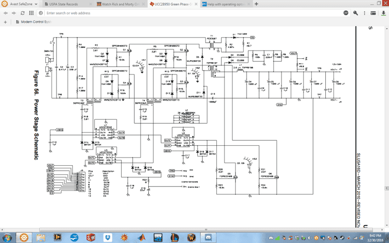

Thanks for all the responses guys, I'll try to be clearer:
I am using the UCC28950 pretty much exactly how it is outlined in their application note. The only differences are that the output will be 360V DC and the regulation mechanism I plan to employ has optoisolation between the control stage and the power stage. So the signal going into the EA- pin will come from the optocoupler in a common-emitter configuration. (basically the last picture i posted will be how I isolate the power stage and control stage from one another)
Here is the datasheet for the UCC28950. Luckily, there is an excel sheet that they link to which I am using to select components (along with double checking to make sure it follows with their math on the datasheet).
http://www.ti.com/lit/ds/symlink/ucc28950.pdfSo, in short, my question could most clearly be:
How can I best operate the optocoupler in linear mode so as to allow optically isolated regulation.
I have attached the screenshot of the powerstage schematic as presented in the datasheet.

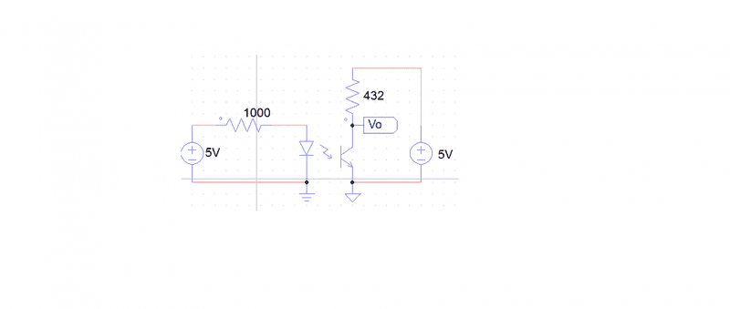

Hmmm, so I've read through the application notes for the optocoupler and I came up with the following circuit which according to my math, should give me Vo=2.624V for the following reasons:
CTR = 1.1 @ 5mA
Vce (sat) = 0.4V
So in my circuit:
I_f=5mA
I_emitter = 5.5mA
I_emitter*432 = 2.376V
V_o = V_CE = 5-2.376=2.624
However, when I actually build this, I get Vo = 4.9, basically 5 almost as if there is no current transferred at all
Can someone let me know if my understanding of how optocouplers work is off or my analysis on this circuit?
Also, even taking into consideration the 1.3 forward voltage and assuming CTR=.5, I remade the circuit with the input resistor now 430 so that If = 0.01157, I_emitter = .005785 and I still get Vo=5 instead of the calculated 2.49.
Also, the device is actually this one: http://datasheet.octopart.com/MOC212R1M-Fairchild-datasheet-1287.pdf
I tried hooking up the input side to a constant current source but no matter how high i put it (up to about 100mA), no current was transferred to the other side. I even got a new optocoupler and still have the same problem... I'll keep trying stuff and posting anything here in case anyone else ever has the same problem.
I figured out the issue, I had tied the base and emitter to ground (as per an older schematic), however, upon more reading, I discovered that there should be some resistance (or capacitance) between base and ground. This fixed my problem. Thank you to everyone who helped.
