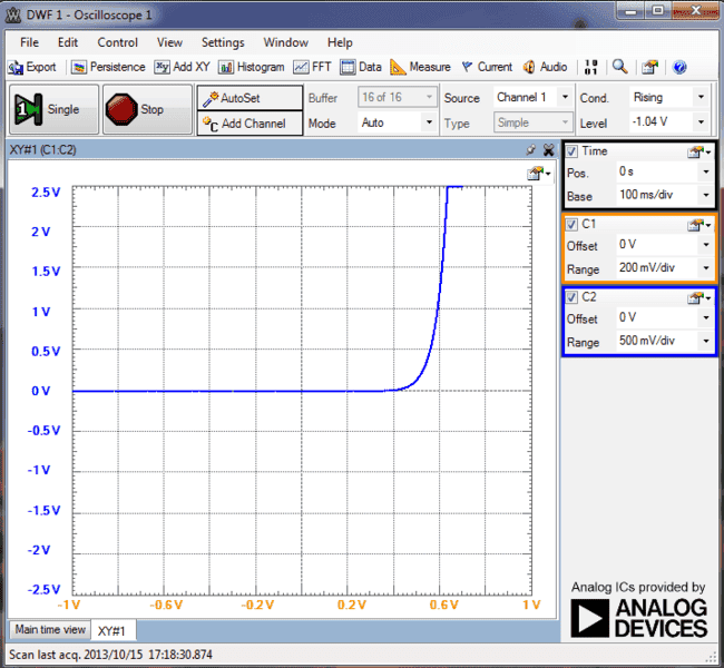

I have performed a small experiment to obtain the VI characteristics of a semiconductor diode using ANALOG DISCOVERY circuit design kit.
I have connected the arbitrary waveform generator (function generator) to a series combination of a 1N4007 diode and a 1 kilo ohm resistor.
To obtain the VI characteristics, I connected the terminals of oscilloscope channel 1 across the diode (to obtain the diode voltage as a function of time) and channel 2 terminals across the resistor. The voltage across the resistor is proportional to the current in the circuit according to ohm's law. (since I have chosen a 1 kΩ resistor, the numerical value of voltage (in volts) across R is the same as current (in milliamps)...
In XY mode, I obtained a plot channel 1 (V) vs channel 2 (I).

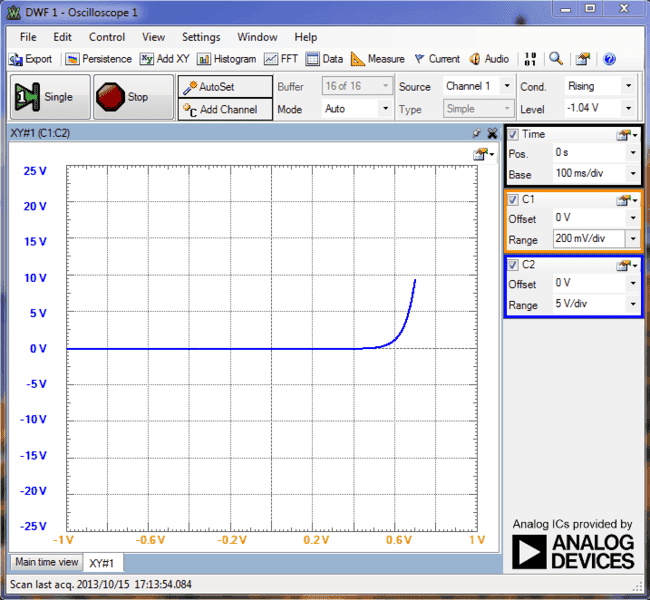

Then I changed the current scale of the VI plot by varying volts/division for channel 2.
It appears to me that the cut in voltage of the diode is varying with the scale chosen. for 5V/div resistor voltage (5mA/div current), the knee voltage is about 6.5 V but as i decrease the scale, the knee shifts toward the left... For 20mV/div (20μA/div) the knee voltage is less than 0.4V. My inference to this observation is that the cut in voltage depends on the current range in which the diode is being operated in the circuit. Does this mean that for a silicon diode, the knee voltage need not be 0.6 to 0.7V? Or is that defined only for a particular current range? If i am using the diode as a rectifier, I might be dealing with currents as high as 2 to 3 amps. If i plot VI characteristics for that range, i believe the knee voltage will be more than 1V...
Why is it said that the knee voltage or cut in voltage of diode is 0.6 to 0.7 V?
Any detailed explanation about knee voltage of diode please reply! Thank you!
I think this is just an effect of the scaling. You can get a similar effect if you plot f(x)=e^x with different scales. Zooming in by a factor of e in vertical direction is equivalent to a shift of 1 in horizontal direction.
"Knee voltage" depends on the current range you consider, if the IV curve is exponential (or not so far away from that).

No I am not actually varying the current. I used a triangular waveform with 10 V (peak to peak). the curve is obtained when the software generates the plot by capturing instantaneous voltage values across Diode and Resistor. If i am to relate this the the "manual" method of varying the supply voltage in regular steps and noting down the current values, what i am trying to say is that If I use a voltmeter and a milliammeter which can measure up to 3 or 4 decimal places, and if I tabulate V and I values for different ranges, and plot the graph for each range, (with appropriate range so as to accommodate the entire VI plot for that range) I get different knee voltages which can go as low as 0.35 V... If a choose a larger scale, the knee voltage can go upto 1 V. If this is the case, why is it said that the knee voltage is 0.2 to 0.3 volts for germanium diode and 0.6 to 0.7 for a silicon diode?

Yes even I inferred that this is due to scaling effect... But this means if i am using the diode in nanoamperes range, may be the knee voltage will be about 0.2V. But that doesn't mean I am using a germanium diode does it? Isn't is important to mention the scale along with the knee voltage?
I guess there is an option to set the scale to be logarithmic. But never tried it! Well I will try it. But what should i expect when the scale is set to be logarithmic?
I don't think the knee as visualized and judged on different scales is in any way meaningfull. Exponential curves will look self similar at any scale, as you can see.
There is conduction at small forward voltages as defined by the diode equation. The choice of 0.7V for silicon diodes is arbitrary but convienient. I suggest you work out values for Is and n and see if they fit.
