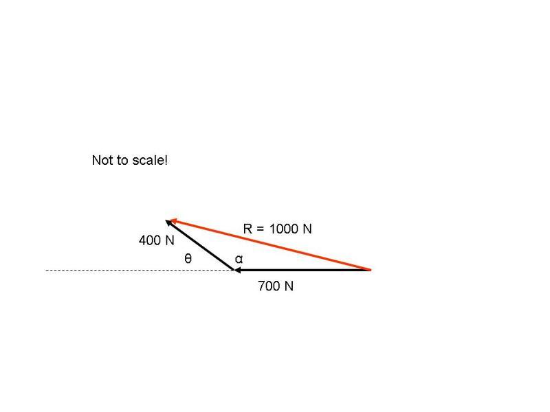

does anyone know how to do this question?
http://img522.imageshack.us/img522/7416/staticssm6.jpg
i've tried to work it out but i just can't seem to get it.
i've tried the using the usuall trigonometry stuff but i can't seem to appply it to this question.
thanks
scott.
Show what you've tried.
i've just tried to see if i could work out the angle using SOH CAH TOA.
i thought i could do: theta= cos(to the minus1) 700/400 but i get a mathmatical error on my calculator, anything else i can think of seems like a dead end.
I'm not really looking for the answer, just some help on how to do the problem.
What you have to do is add those two forces and set the sum equal to 1000 N. Then you can solve for the angle.
There are several ways to add vectors. One way is to add them graphically and use some triangle geometry. (The law of cosines.) Another way is to find their components, add those, then find the resultant. Either way should work.

scotthands said:
i was going to add them the tail to tail method but that won't work because i don't know the angles.
I assume you mean "head to tail" method. This will work just fine. You'll get a triangle for which you can use the law of cosines to find the resultant (which would be one side of that triangle). You don't have to know the angle, since that's what you're trying to find.

You can also just add the components and find the resultant that way. The magnitudes of the horizontal and vertical components of the 400 N force would be [itex]{400}\cos\theta[/itex] and [itex]{400}\sin\theta[/itex]

No, that's not correct. You can check by finding the components of the resultant: You'll find that the horizontal component alone will be greater than 1000 N.

COSA= (700squared + 1000squared - 400squared)/ (2*700*1000)
You want the angle opposite the 1000 N side, not opposite the 400 N side. But you're on the right track with the law of cosines. Be sure to draw yourself a picture with the sides and angles labeled.

Just use the same formula, but chose the 1000 N side as the side opposite the angle. You won't get 90 degrees.
ok i think I've got it, i got 128.68 degrees for the angle.
Almost. Did you draw yourself a diagram of the vector addition? It would look like: A horizontal arrow (length = 700 N) pointing left plus a 400 N arrow at some angle (diagonally up and to the left) adding up to the resultant (at some other angle up and to the left) of length 1000 N.
That's the triangle that you are working with. What you found--correctly!--is the angle within that triangle opposite to the 1000 N resultant. Now use that to find the angle that they call theta.
what does it mean by " for this condition, what will be the angle between R and the horizontal P?"
I assume that they want the angle the resultant makes with the horizontal. That's the angle in your triangle that's opposite to the side 700 N. (No idea what "P" means.)
a diagram
Here's a diagram of the situation.
Note that you found the angle labeled [itex]\alpha[/itex], but you need the angle labeled [itex]\theta[/itex].

yeah, ok , i see what I've done now, I'm getting 51.32degrees for the angle theta.
i guess i'll be able to work out the angle across from the 700N now too.
thanks for the help.
Good. That's the angle I think they want.
