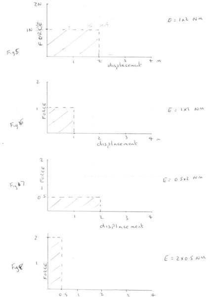

Since I am replying I had prepared further information for sahil in the attachment.
You asked about the introduction of an integral of force over distance.
Yes indeed energy can be counted as an area.
We say that work is done when a force moves is point of application.
The movement is usually called displacement rather than distance so I have labelled one axis that way on my graphs.
Now the graphs are not the same as say, the graph showing the conversion of $ to £. The area under such a graph has no meaning. All the meaning is in the line so we can read off say
£8 = 10$.
I have shown this in fig 1 in the attachments. The only valid values lie on the line £ = contstant x $
However we can allow our force to have any value and move any distance so any point in the xy plane is acceptable. this is shown in my fig2
Taking some particular values say F = 10 and d = 1 we can plot this as a point.
The movement must have started out at zero displacement and moved through all possible values of displacement < 1 until a displacement of 1 was reached.
If F is a constant force such as gravity, the action will have taken place along the dashed line in Fig3 parallel to the x-axis at F=10.
The energy is equal to the work done = force times distance which is equal to the area of the rectangle under bounded by the two dashed lines.
If you like it is made up of all the little contributions from d = 0.1; d = 0.2 etc. That is what is meant by force over distance rather than just force times distance. The integral can also be used to calculate sums (if you have not yet covered this you will) and this is an example.
The energy figure or shape is not always a rectangle.
In fig 4 I have shown what happens if we extend a spring.
At the outset the restoring force is zero so no energy is used to extend it.
At some value of extension d there is a restoring force F which has built up from zero to F.
So we take the average or
[tex]\frac{{\left( {0 + F} \right)}}{2}[/tex]
for the force and our area is a triangle as shown.
In fig 5 I have put some other numbers to the constant force graph for comparison
In figs 6, 7 and 8 I have shown different ways to obtain the same energy as
E = force x displacement
E = half the force x twice the displacement
E = twice the force x half the displacement
