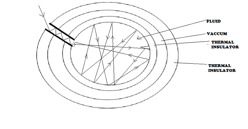

Well, i read about the concept of a black body...
So, i was trying to develop a system which would absorb all the radiations falling on it.
As a perfectly black body is nearly impossible.
So, what i am planning to do is to have a fluid withing a multiple layers of thermal conductors and insulators having highly polished surface from inside.
The fluid is suppose to be at a very low temperature somewhere around 100 k or so, so that it attracts all the heat. And all the other properties that i listed in my original post are going to facilitate in the absorption of thermal radiations.
I have attached a simple layout of the desired system...
kindly help me out with it...

Your diagram of a liquid filled container shows multiple internal reflections. If the internal surface was not polished it would absorb energy sooner and so reduce reflected energy passing back out through the window.
It does not matter which way the shiny or the matt side of an insulating sheet faces, it insulates either way. It is still better to polish both sides.
If you want the liquid to absorb all energy then presumably you will monitor it's rising temperature. At some temperature it will evaporate. Thermal radiation from the liquid will increase as the temperature of the liquid increases.
If you want to absorb all radiation passing through the window then you may as well let it evaporate the liquid and vent the gas elsewhere, the temperature will then remain constant without need for high thermal capacity. That will stabilise the rate of radiative heat loss and make for simpler flux measurements.
A perfect thermal sink is a broadband transmission line or a pipe, not a cul de sac, reflector or lake.
