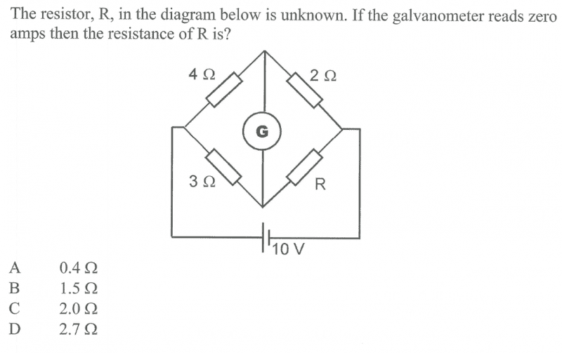

Hi all. I got 3 Ohms in this question (top current = bottom current hence equivalent series resistance of top 2 and bottom 2 resistors must also be equal), but is that really the right answer? There is no option for 3 Ohms so I am beginning to doubt myself.
Wheatstone bridge circuit diagram with resistors of 4 Ω, 2 Ω, 3 Ω and unknown R, a galvanometer G across the middle, and a 10 V cell at the bottom; answer options A to D are listed below.
  • Wheatstone bridge circuit diagram with a galvanometer G in the centre branch, resistors 4 Ω and 2 Ω on top, 3 Ω and R on bottom, a 10 V battery at the bottom, and answer options A to D (0.4 Ω, 1.5 Ω, 2.0 Ω, 2.7 Ω).

Please use the Homework Help Template the next time you start a schoolwork question thread here. Thank you.
Your answer appears incorrect to me. Can you show the work you did to arrive at it? :smile:

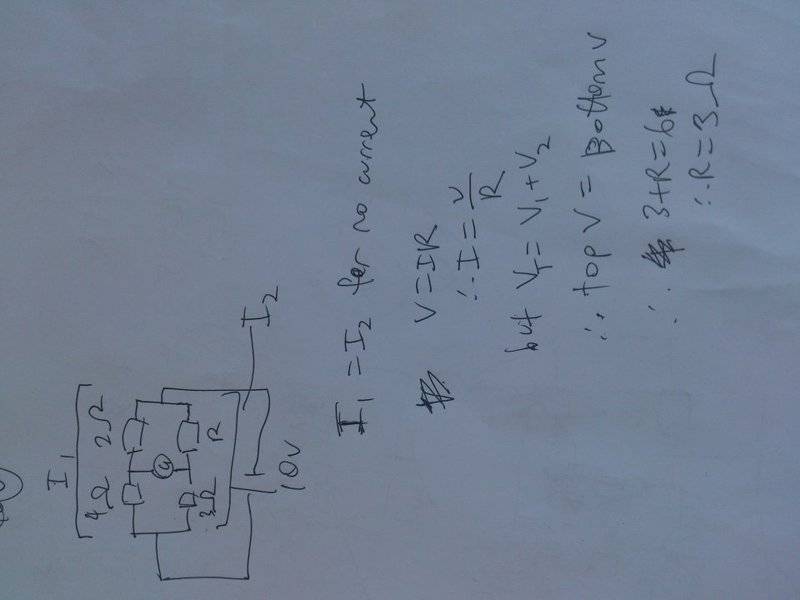

here is my answer: http://imgur.com/a/LJo5Y
  • Handwritten working, rotated sideways, beside a circuit schematic with resistors marked 4 ohm, 2 ohm, 2 ohm, 3 ohm and R, a meter in the centre, a 10V source, and currents I1 and I2. Text reads I1 = I2 for no current, V = IR, I = V/R, but V_T = V1 + V2, top V = bottom V, 3 + R = 6?, R = 3 ohm.

berkeman said:
What can you tell us about voltage dividers? It's not about equal currents in the two branches, it's about equal voltage dividers... :smile:
ok when i equate the Vout of the top and bottom, i get 1.5V. that is the correct answer but it doesn't make sense in my head. why should the bottom resistances be lower than the top? using the water pressure analogy, wouldn't more electrons want to flow from the 2 ohms to the 3 ohms than R ohms to 4 ohms because they encounter less resistance there than the 4 ohms?
edit: what i am also trying to say is, is there another way to do this aside from using the concept of voltage dividers?
edit: hangon i get it now. thanks very much. I've never seen voltage dividers ever in my life before but it is intuitive.
