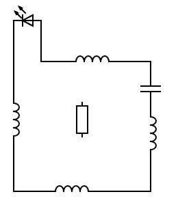

In summary, the purpose of the AC-generator is to create a voltage over an LED. The circuit diagram can be seen in the attached figure. It consists of four coils attached in series and a rotating magnet in the middle. I first tried with only two of the coils on either sides of the magnet, and got 1 volt. I then tried adding the other two coils and also got 1 volt, but I need at least 2 volts to make the LED work. I suspect this was caused by a phase shift of the voltage of the two other coils, which gives 0 volts when the first two give 1 volts. I suspect that adding a capacitor should make a phase shift and add the voltages from both pairs of
papercace
I have tried to make an AC-generator to create a voltage over an LED. The circuit diagram can be seen in the attached figure. It consists of four coils attached in series and a rotating magnet in the middle. I first tried with only two of the coils on either sides of the magnet, and got 1 volt. I then tried adding the other two coils and also got 1 volt, but I need at least 2 volts to make the LED work. I suspect this was caused by a phase shift of the voltage of the two other coils, which gives 0 volts when the first two give 1 volts.
I suspect that adding a capacitor should make a phase shift and add the voltages from both pairs of coils so I can get 2 volts. I am just woundering if I am going in the right track. Will adding a capacitor as indicated in the circuit diagram give me the result I want of giving the same phase to both pairs of coils?

For the time being stay with two coils and no capacitor. With a strong (rare-earth) magnet you should have no trouble lighting the LED. Do your coils have an iron core? They should Series is correct but all the turns should be in the same direction when you connect the two.coils. It should work fine. If not we will need detailed info.
You should put a reversed power diode in parallel with the LED to limit the reverse voltage across the LED. Take a look at the reverse voltage specification for the LED you are using.

But theoretically speaking, could the construction with the capacitor work?
I don't think that is a problem since I don't get a high enough voltage to break the diod.
Maybe not now with 1 volt, but check it out. The reverse breakdown voltage is often less than the forward voltage needed to light the LED.

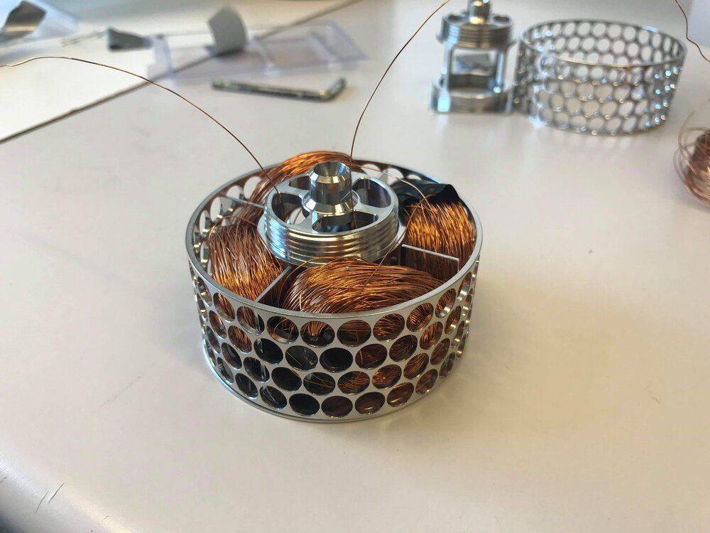

Maybe a picture of your alternator would help us identify the easiest way to improve the performance.
Here is a picture.

You got off to a good start by building something that can be optimised.
1. What is the outer perforated tube made from, aluminium, stainless steel or?
The perforated outer housing that is full of holes looks good, but should be a plain iron tube. Iron pole-pieces, in the middle of each coil should be attached against the outer housing and should reach close to the moving magnet poles. That will support the coil and form a magnetic circuit through the coil.
2. What is the flat material between the coils, clear plastic, or aluminium, or?
3. How is the rotating magnet supported?
If the magnet rotates inside a fixed metal cage, the holes in the cage will act as single shorted coil turns, so the backward eddy currents in the cage will generate a magnetic field that cancels most of the rotating magnetic field that you intended for the wound coils.
