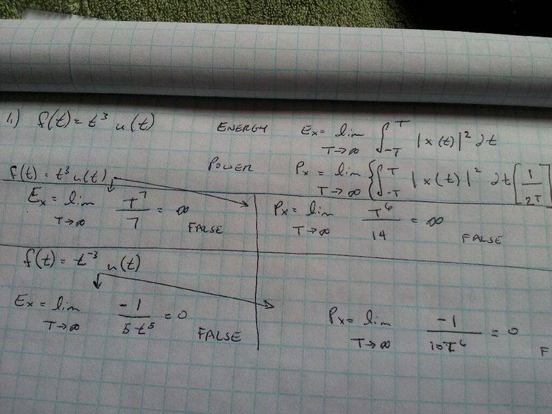

View attachment problem1.pdf
I was trying to solve out this problem for homework and I came to the answer of all of them being false because they all went to infinity...but I have a gut feeling that this is wrong.

this signal is neither power signal nor energy signal !
and use TeX for goodness sake. what is this with all these new persons that just whip their iPhone out, snap a pic of their notes or of the white board and post that?
what should i do, write my answer on a piece of paper and put that up as a jpg in response?
