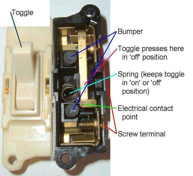

The sort of problems described above can be indicative of routine wear and tear absent of any other failure.
Courtesy of Wikipedia:
The above picture is blatantly NA-biased but chances are the snap switch in question is relatively similar to the above pictured. These control devices are mechanical arrangements with a limited service life. For the average wall-mounted toggle age is a big factor to consider in service life as the materials used in manufacture have come leaps and bounds since the days of bakelite ect. A common problem with this lever and detent system for holding an electrical contact together involves a situation where the (usually) nonmetallic housing cracks or separates away from the normally metal mounting strap to which it is jointed. The lever system loses its fulcrum point and typically the springs that a snap switch normally has can fall out of arrangement, leaving the contacts to flop around willy-nilly, creating all sorts of fun problems one would normally find with a bad connection, most notably intermittence and heat.
This does not completely rule out an overload or other fault situation. Another way in which a switch of this type can easily fail is for the current-carrying metal parts to become very hot due to carrying more demand for current than its material design can cope with causing parts to melt and once again throwing the arrangement of the system out of whack. This sort of runaway failure is a common theme in electricity, for example a slightly cracked case may put insufficient pressure on a spring to fully engage the contact point it presses on; this can create heat which alters the metal and transfers to the plastic, which may melt and lose mechanical strength, which further propagates the faulty contact... and finally, cue the magic smoke!

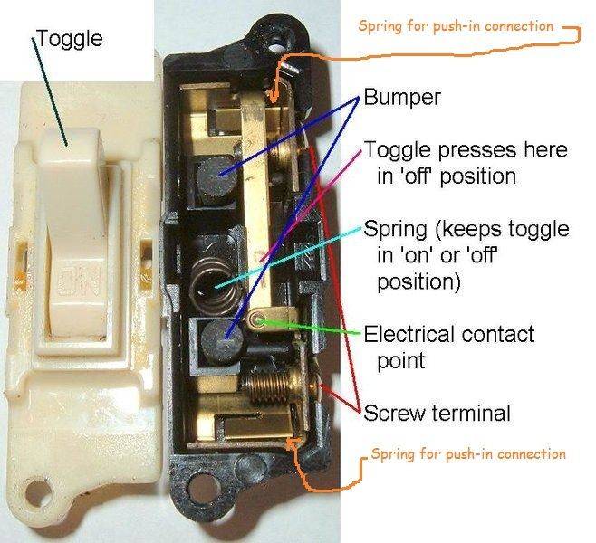

Perhaps live to the other room with the heater was supplied via the switch terminal, eg the switch terminal was used as a junction box. If that the became loose it could burn up the switch.
As others have said.. a photo of the switch would be nice to see.
Indeed , and krater's great picture shows what looks like springs for those 'push in' connections from the back.
"Live" might come into the switch via the top screw terminal and continue on to next room via the push-in. Looseness at either would make heat whenever the heater(or anything else) in next room is ON drawing current.
Speculation of course but exactly the sort of thing electricians find.
Myself i won't use those push-ins. They're not even allowed on 20 amp rated fixtures anymore, just 15 amp.

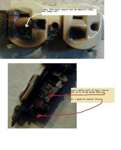

I took a peek...the wires all seemed Fried on the side closet to the outlet...It was a gradient..
I don't like to euphamize arcing faults particularly by using tame-sounding descriptaves like sparks or flashes. I prefer to discuss them more accurately as fire shooting out of things. Very hot gas, liquid metal, and everything it's carrying end up in places. It doesn't always make sense. It is the reason the moving parts that can pass such flatulence normally exist in a box.
quickquestion said:
The coating of the wires that were near the wall were not fried. It was a gradient, the closer to the outlet they were the more fried they looked.
It's a safe bet that is where the heat source was. An insufficiently tightened screw terminal can cause that , the wire eventually relaxes maybe from thermal cycling and the joint becomes resistive. That exaggerates the thermal cycling with load.
A wire that's charred at a connection and becomes less charred as you look further from the connection is a giveaway. The connection was the source of heat.
Were the circuit overloaded the wire would heat along its whole length. That's what circuit breakers protect against.
When a "bad" connection gets 'bad enough", normal load current will overheat it.
So, while we lack enough details to absolutely nail down your problem, you have presented circumstantial evidence of a loose connection.
I hope you find the "smoking gun" , so as to put your mind at ease.

Snipped from your pictures
Without handling it , just going by your photos
i would say it looks like you had a loose neutral connection through which current from a significant load ( like a heater or airconditioner) was returning..
If that's right the receptacle had to be getting warm before it went up in smoke. That's why it's good to feel of them now and then especially in heating season.
But troubleshooting from a distance is very tentative .
Thanks for the pictures and for letting us know !.
