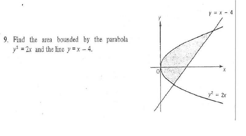

I am having trouble with this question: (QUESTION AS ATTACHED)
This is what I tried to do:
I found the intercepts of the difference of the two functions which I found to be only 8.
Then I integrated this into the new function:
[tex]\int{\sqrt{2x}-x+4}[/tex]. with limits of 0 and 8 (I don't know how to Latex this)
This, according to my Graphics Calculator yielded 21.3.
However, the answer is 18, what have I done wrong?
Edit: [tex]\int_0^8 (\sqrt{2x} -x + 4)\,dx[/tex]
  • Graph of the parabola y^2 = 2x opening to the right and the line y = x - 4 crossing it, with the bounded region between them shaded. Question 9 text is printed to the left.
First, find where the line intersects the curve.
Then from the points of intersection, draw a horizontal line to the y-axis, what shape is formed with the straight line and these two new lines you just drew? What is the area of this shape?
EDIT:
I see what you are doing now. Your way will be the same, you will need to subtract the same amount of times.

rock.freak667 said:
Then from the points of intersection, draw a horizontal line to the y-axis.
I am not sure what you mean here, but is the answer a triangle?
Yep. You can get the area of the triangle. You can get the area of the region bounded by the curve and the y-axis and then subtract.
I think that this would work best as a double integral. Your y-limits are between 2 and 8 and your x-limits are between y^{2}=2x and y=x-4, this will give you the correct answer.
Mat
It is easier to calculate the area enclosed by the lines of the inverse functions, x=y+4 and x=y^2/2.
ehild
