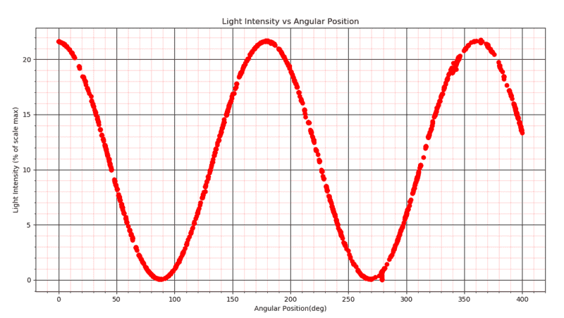

Python:
r = np.arange(0,400,0.1)
t = np.cos(r)+10
plt.plot(r,t)
How can I use the range of the cos function to look like this
Do you mean
change t = np.cos(r)+10
to t = np.(cos(r) + 1) edit: or t = 12*(np.cos(r) + 1) ; if np. is not the amplitude
so that the lower extreme is on the y=0 axis?
Merlin3189 said:
Do you mean
there's a syntax error in your code. Also no, I mean that I need to write a cos function that will look like my graph. Or cos^2x function. Both are okay for me
Sorry. I'm not a Python person, so I don't know "np." nor "plt." . They look like references to objects defined elsewhere, but there's no way I can see of knowing what those objects are like.
I just noticed that +10 would leave some negative values.
I'm not sure what you want that's different from the graph you're getting? I can't see where it gets the y-axis values, but that's probably just how you've labelled the axis.
What's the wavelength of ##\cos(x)##? What's the wavelength of your graph? What do you need to do to your array ##r## so that the wavelength matches?
What are the minimum and maximum values of ##\cos(x)##? What are the minimum and maximum values of your graph? What do you need to do to make them match?
Have you seen this formula before: ##y = A \cos(\omega t + \phi)##? A is the amplitude, ##\omega## is the angular frequency in radians per second and ##\phi## is the phase angle in radians. You need ##\omega## so that it has completed two revolutions for t = 360 degrees.

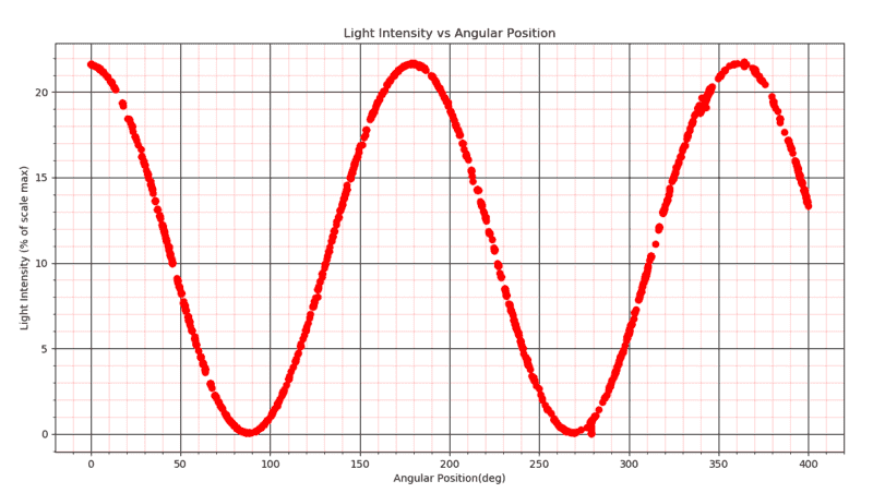

Python:
r = np.arange(0,400,0.4)
t = (11*np.cos(r/28.7))+11
plt.plot(r,t)
I guess I find it :) , This works well
