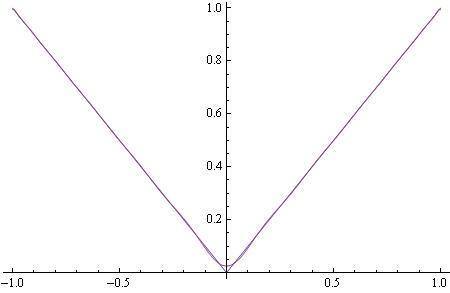

Sorry if I caused some awkwardness with the convergence question above, something I barely understand myself. I just want to post some empirical results cus' I'm curious. The plot below is the actual function and a plot of the first 25 terms of the Legendre expansion created with this Mathematica code:
Code:
f[x_] := Abs[x];
clist = Table[((2*n + 1)/2)*
     Integrate[f[x]*LegendreP[n, x],
      {x, -1, 1}], {n, 0, 25}];
g[x_] := Sum[clist[[n]]*LegendreP[n - 1,
      x], {n, 1, 26}];
Plot[{f[x], g[x]}, {x, -1, 1}]
