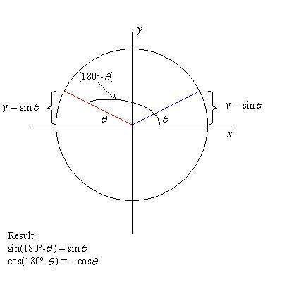

How did mathematican define sin A ( A >90 degree) as y/r?
Are there any proofs to sin 150 = sin 30 >?
The proof looks like, sin (180-A)= sin A, how can I get the geometry proof of this ?

In high school (or was it junior high, can't remember now), we were presented with an expanded definition of trigonometric ratios (sine, cosine, and therefore tangent) in terms of a unit circle. Visualise (or better yet, draw) a circle of radius 1 (a unit circle) centred at the origin of an xy coordinate plane (for convenience). Now, your coordinate axes pass through the centre of the circle. We will measure the angles between various radii drawn and the reference axis, which we will define to be the horizontal (the positive x-axis). So, a radius of the circle, a line joining the centre of the circle to some point on it's circumference, forms an angle [itex] \theta [/itex] with the horizontal (the reference axis). Before I continue...have you seen this already in math class?
Yes. Would you like to go on?
Diagram Attached
I drew a diagram to help illustrate the situation, but maybe I should withold comment until it is approved. I'm not sure what constitutes a geometric proof. Nevertheless, the diagram makes it clear that [itex] \sin\theta = \sin(180^o - \theta) [/itex], where [itex] \sin\theta [/itex] is defined as [itex] y/r [/itex] for the coordinate point at which the ray forming the angle theta with the reference axis intersects the circle.

Anyway...the image is there now...plus James' proof using the subtraction formula
Thank you for the nice picture.
I know the meaning of x,y,r.
However, how to prove than sin(180- A)= sin A
It shows it right in the diagram! The two angles theta and 180 - theta clearly have the same y-components...

no...that's the whole point of having the unit circle...like I said before, the defnintions of the trig ratios were expanded so that sin(theta) = y/r. Can you not see in the picture that the line forming an angle of 180 - theta with the reference axis also just forms an angle of theta with the negative x-axis (there's your right triangle)...therefore they have the same y-component...it's obvious...y/r is the same for both.
