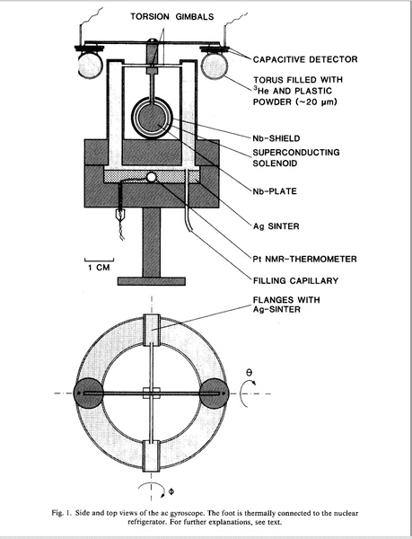

To summarize:
1. The solenoid is supplied with an AC voltage.
2. Produces an AC magnetic field out of the page
3. Exerts an AC magnetic force on the Nb-Plate that's placed just outside of one end of the solenoid
4. There is a fluid circulating in the torus, with angular momentum L in the z-direction (out of the page)
5. What is the torque exerted on L due to the oscillating Nb-plate which forces the torus to oscillate with it?
Directions: ∅ (Left-right), θ (In-Out of page)
I'm not sure how they got an extra θ0 term in their torque about ∅. I know in small oscillations, the magnitude of change in L is
ΔL ≈ θ0L
Alternatively, considering change within half a period = T/2:
ΔL/Δt = 2θ0L/T = 2fθ0L
which also doesn't match their expression..

Which extra θ0 term are you referring to because I do not see an extra.
Also, are you not missing a pi term in
256bits said:
No response yet!
Yeah, I did it two ways. Both don't match the expression they have derived..
I think I know their line of thought, correct me if I'm wrong:
In time Δt, the vector (θ0L) moves through an angle Δ∅. Hence
ΔL = (θ0L)Δ∅
Taking limits of Δt → 0,
dL/dt = (θ0)L(d∅/dt) = θ0
