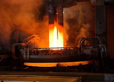

I'm highly interested in building my own small arc furnace for hobby use. Thus, I want to understand the nature of electrical arcs before proceeding to have maximum control over my design. So far, I know that electrical arcs form when the dielectric strength of the material (in this case, a gas) is overcome. Once this barrier is overcome, the gas becomes locally ionized, allowing electricity to flow with relative ease.
What I don't understand is how the arc sustains itself. From what I understand, this plasma formed has very low electrical resistance. Without significant resistance to generate heat, how is the plasma sustained? I also want to know how one would control the intensity of the arc and thus the temperature of the furnace, but I feel that the answer to the previous question will lead into this.

An arc welder employs series inductance to keep the arc running. It regulates the current with either a series resistor and or an adjustable choke transformer. The choke limits the current by saturation of the partially withdrawn core. You could use an arc welder transformer as your current limited current source.
I'm not sure I'm following entirely. Limiting the current of the circuit allows the arc to sustain itself? This is what I didn't understand in the first place - since the ionized gas is very electrically conductive, where does the heat energy required to sustain the plasma come from?

I question the configuration of your arc furnace. It will probably depend on the resistivity of the material being heated.
Is the material being heated by a current flowing through the material with a short arc at the electrode contact ?
Or, is the radiation from an arc being used to indirectly melt a resistive charge, without the charge being part of the circuit ?
An arc is usually started by electrode contact or a very short gas ionisation breakdown. Once an arc is struck, the ionisation continues, an inductor dynamically adjusts the arc voltage to keep the current flowing; as V = L * di/dt. The current is usually limited by the magnetic circuit of the transformer.

Commercial arc furnaces melt scrap steel for recycling. When something big and solid like an engine block touches the electrodes, it is like a big short circuit that comes and goes as the object moves and vibrates. If not properly engineered, nearby utility substations explode. Arc furnaces are the most undesirable load I can imagine for a power grid. The best way to design them is to build them in someone else's country. :wink:
Welding machines are analogous to arc furnaces but they are designed to protect the grid from the bad effects.

Welding machines based on inverter technology are now available. They use electronics to regulate the current. They are used for stick and TIG welding and sometimes called caddy welders because they are light weight movable units. They usually produce DC which may consume your electrodes faster than AC. They cost $200+ new, but are less reliable than the old adjustable transformer welders.
A transformer based arc welding machine is designed to produce about 25V at 100A. The current is not limited by the resistance of the circuit but by the adjustable geometry of the magnetic flux in the core of the transformer. Transformers produce AC but it can be rectified to DC by a diode bridge if you need that.
Bigger transformer welders run from three phase AC, or two phases of the three phase AC. Smaller units run on a single phase and neutral. Make sure you have access to the power you need for any particular machine.
There is a big screw through the transformer that positions the movable part of the core to set the current limit. Look for a welding transformer with a handle that moves the magnetic core, with a pointer that shows the core position and expected current. One example if you google images or search the auction sites is an 'EMF Transarc'. Expect to pay below $100 for a good second hand unit. The scrap value of the copper is greater. Try to get one with some heavy cables. They are cheap because they are heavy.
Three-phase arc furnaces have three electrodes above the charge. 3PH is a good way to make an arc furnace since the arc transfers progressively around the electrodes as the AC cycles. You can use three identical choke welders to reduce the 3PH voltage and to limit the power for a high current arc furnace.
