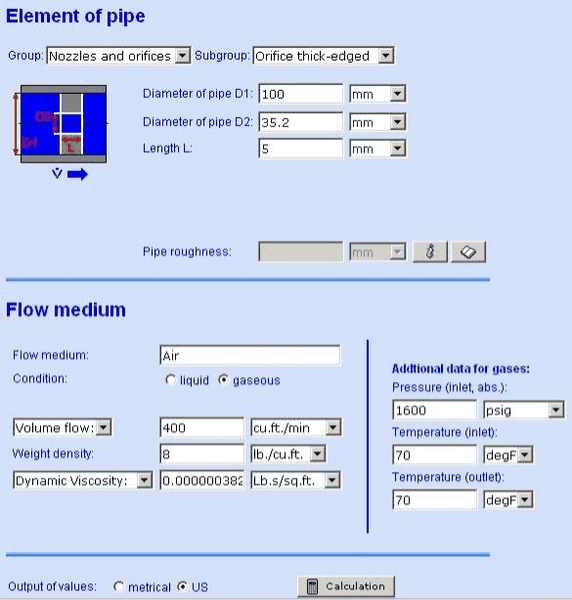

I am trying to size an orifice to place on an outlet of an air vent line. The reason for this is that I am installing a noise suppressing muffler, but it is only rated for 300 psig. Since I am venting a line that will be pressurized to 1600 psig, I'd like an orifice restrictor in order to reduce the outlet pressure to something less than or equal to 300 psig. My question is how can I properly size this orifice to allow this much of a pressure drop, without getting too overly complicated in my approach?
My first thought was to use the equation for choked flow to figure out my flow rate through the orifice. If this flow rate is less than my maximum allowable flow rate specified by the muffler (400 scfm), then I at least have that much taken care of. But how can I verify that I maintain <300 psig on the downstream side of the orifice?

I thought you wanted a «not too overly complicated approach» (what's simpler than an online calculator?) to determine the size of an orifice inside a pipe with a 400 SCFM air flow @ 1600 psi such that a pressure drop of 1300 psi (= 1600 - 300) is created. If that would've been your problem, the site pressure-drop.com could've done a nice quick calculation for you (although I haven't double check it). For example, with the following inputs:

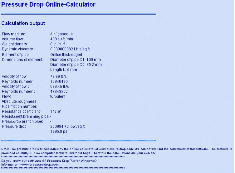

You get these outputs (note the 1395.8 psi pressure drop):
I put other sites such that you could compare the answers and if they are similar, it means that they are probably good and that would've been a «not too overly complicated approach».

Steve, if you WANT 200 psi at some point in the system, put a regulator in. If you WANT 400 SCFM and you can choke an orifice with 1600 psi, put the orifice in. What you seem to be missing is what I pointed out earlier. The backpressure on the orifice is dictated by the flow restriction through the muffler and that has already been taken into account by the muffler manufacturer. So if you choke an orifice at 1600 psi upstream and you have less than 800 psi downstream, it won't matter what the downstream pressure is, it will only flow 400 SCFM. The back pressure on the orifice (the 200 psi you want) is not dictated by the orifice, it's dictated by the muffler, and the muffler won't necessarily give you 200 psi. The muffler manufacturer could tell you what pressure would be upstream of the muffler if you put 400 SCFM through it but you can't calculate that nor can you control it with an orifice.

Thanks for the responses, Q_Goest and jack action. You both understood and answered my question. Jack- you did not misunderstand my question, on the contrary I misunderstood your response (I apologize!). I had not seen the pressure-drop calculator in my searches, so that was very helpful. Q, you are absolutely correct- that is exactly where my confusion was: I was looking for a specific d/s pressure when in fact the d/s pressure is not a factor in these equations (b/c of choked flow). That makes perfect sense in that the only way to get this pressure is to reach out to the manufacturer.
