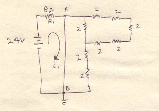

Grounding in a circuit designates a common reference point with zero electric potential, affecting current flow. When points A and B are grounded, they are at the same potential, preventing current from flowing through resistors above these points. The discussion emphasizes that a short circuit does not occur in this scenario, as the grounded points do not create a path for current to bypass the circuit elements. Kirchhoff's Voltage Law (KVL) can simplify the analysis, allowing for easier calculations of current using Ohm's Law. Ultimately, grounding limits current flow beyond the grounded points due to the lack of potential difference.
joej24
76
Number 8
V = IR
The points above the 3 horizontal lines represent grounded areas. They have zero electric potential there. How does the circuit work when it is grounded midway?
I found the total resistance to be 13 2/3
Since V = IR
24 = I * 13 2/3
I = 1.75
Why didn't this work?

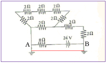

"Ground" is just a designation for a common reference node. Treat the grounds as though they are all connected by a single wire. That puts points A and B in the figure below at the same potential (they are in fact part of the same circuit node).

Hi, just some addition.
Since the two node is connected, short circuit does happen. Therefore your calculation is not sound.
Short circuit does NOT happen.
A and B are actually the same electrical point.

I suggest doing a KVL starting from the voltage source through the
resistor in question to ground potential. It may help if you redraw
your circuit in the standard fashion with voltage source at the left
and ground potential at the bottom.

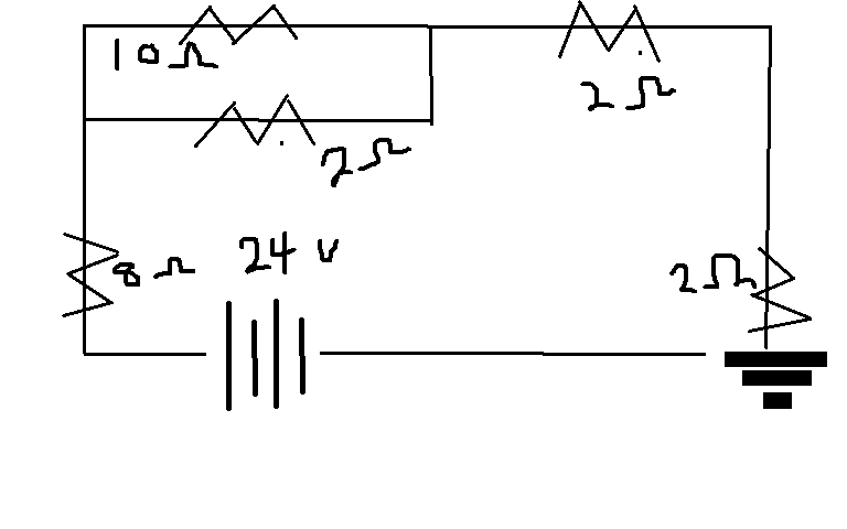

This is my attempt at redrawing the circuit.
How am I supposed to start this problem? My physics class didn't cover any E and M material. Bear with me because I really don't know how to do this.
The grounding part made the entire problem confusing to me.
Not quite, I suggested putting the voltage source at the very left side. As you've redrawn the circuit, you've left out the ground connection between the 8 ohm resistor and the rest of the circuit. Your combined resistances are correct.:smile:

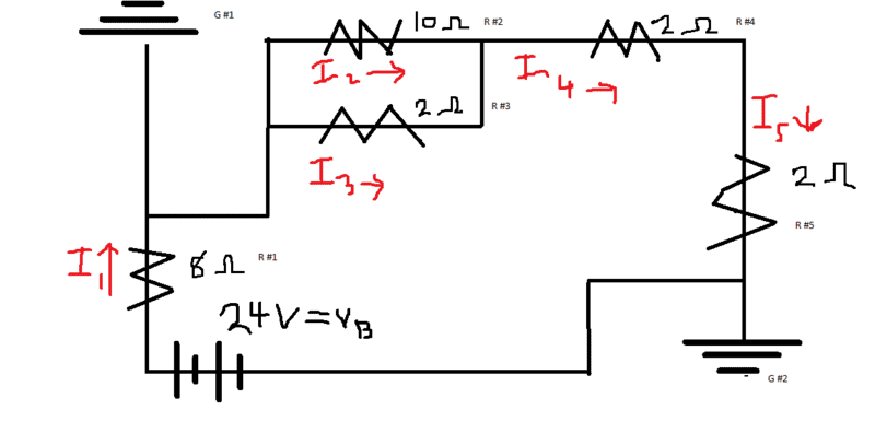

I see two loops here.
Loop 1: Battery, R1, R2, R4, R5, back to bat.
Loop 2: Battery, R1, R3, R4, R5, back to bat.
I guess we could use kirchev's law.
Loop 1: VB - I1*R1 - I2*R2 - I4*R4 - I5*R5 = 0
Loop2: VB - I1*R1 - I3*R3 - I4*R4 - I5*R5 = 0
But if Grounded points have 0 V, From the battery to the G1 = 0.
VB - I1*R1 = 0
24 - I*8 = 0
I = 3 A.
And since they are asking for the current through R1, 3 is the answer no?
And just to make sure, I1 = I4 = I5 right?
Opps. I forget to attach the REVISED circuit drawing :D
I think there should be currents labeled between R 1 and R 2/ R 3 and between R 5 and the battery, but they aren't really relevant.

Since points A and B are one and the same node (they are connected via their "ground" connections), no current at all will flow through any of the resistors above the A,B points in the diagram I modified, because there can be no potential difference between points A and B. Therefore, concentrate your efforts on the 24V battery and the 8Ω resistor, which form a series connected loop.
VB - I1*R1 = 0
24 - I*8 = 0
I = 3 A.
That's right :smile:

here I redraw your original circuit (see attachmt)
I mentioned it is useful to redraw your circuit by standard convention
(voltage source at the left, ground at the bottom) as you can often
analyze them more easily.
Analogous to gneill's drawing, I have connected the two ground points you labelled G1 and G2
(between nodes A and B). You can easily see there is a shorter path for current to flow to ground through the single line A-B, versus going through the rest of your circuit to the right of A-B.
Since the resistance of that wire is very small, virtually all of the current will flow along that path.
An so the current through all the circuit to the right of A-B is virtually 0 A.
That is why you can exclude the impedance network on the right side of A-B, from your analysis, and as I mentioned earlier (post #10) , you're left with a simple circuit that can be solved using Ohm's Law, I = V/R.

Okay. Thanks everyone. I understand the problem now. I have just one last question. Why does the current NOT flow through the wire past the grounded point?
When grounding occurs, does all the current/charges flow to the ground, leaving none for the part of the circuit past the grounded point?
I know the electric potential turns to 0 at grounded points. The ground is connected to the negative terminal of the battery, so the loop continues. There is no potential to do work and push charges past the part of the circuit past the grounded point.
Is this correct?
