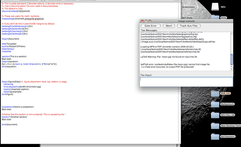

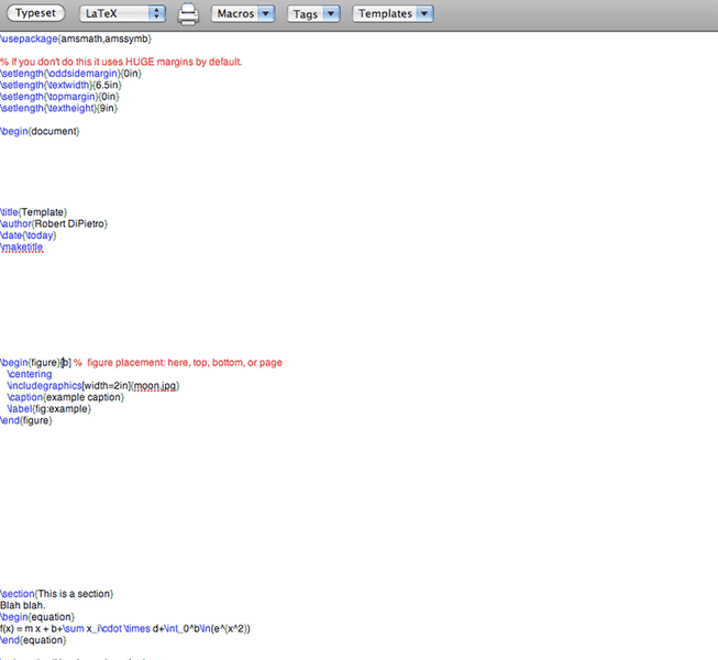

I googled this, but all articles assume previous knowledge of Latex.
I am brand new to Latex. I am using TeXshop on my Mac.
I have a template open and I want to insert a jpg in the document.
I clicked on the "Graphics Template" and then pasted the the name of my picture in there like the template implies. But that doesn't do it (nor do I think it should). Clearly I am missing something here.
Here is a screenshot of my attempt.
Thanks,
Casey
What is your error message?
did you use \usepackage{graphics} or \usepackage{graphicx}?

I tried \usepackage{graphicx} but got nothing... noob question: I put "\usepackage{graphicx} " with all the other "usepackages" at the top of the page right?
Where does the mage need to be saved? Does that matter?
Error message:

So I went to this site and copy/pasted this into a doc:
\documentclass{article}
\usepackage[pdftex]{graphicx}
\begin{document}
This is my first image.
\includegraphics{myimage.png}
That's a cool picture up above.
\end{document}
I saved an image as "myimage.png"
I compiled and got nothing.
So I deleted everything except document class and such.
Then I just drag-and-dropped the image from my desktop to the doc and it worked!
It appears to have put the entire file path which I am not sure why the website does not?
This is kind of annoying. The template implies that you only need to put in the argument {moon.jpg} but when I do that, it does not work.
When I drag and drop an image it automatically prints the line with the entire address. But the address looks like this
../../Users/me/moon.jpg
It literally prints the dots "..."
I use a Mac and cannot figure out how to find the address for certain files?
On PC its just right-click-->properties and you're there.
But with Mac?

Is your image in the same folder as your tex file? If so, then you should not need the entire path.
