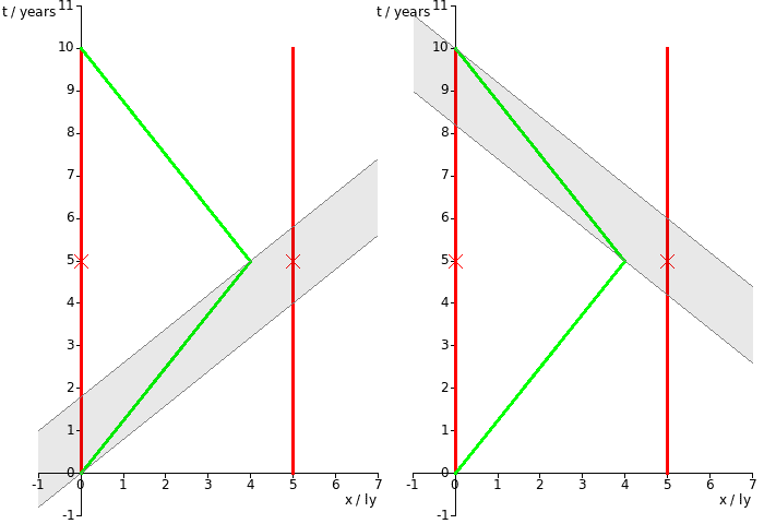

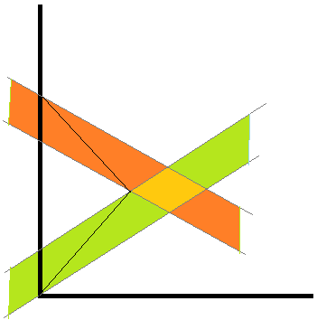

  • #31
hutchphd said:
Can one not use two clocks, separated but stationary with respect to the observer as an accelerometer? Any change in the synchrony of the clocks will indicate an acceleration.. (?)
Which observer do you mean? One who accelerates stationary with the clock or an inertial observer?

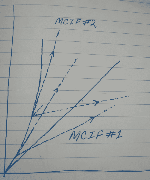

In principle an accelerometer does not need calibration because they are based on defined measurable local effects. Of course, in practice many accelerometers need to be calibrated to get the most accurate reading, but that is not an “in principle” problem.
In a gravitational field it becomes fairly easy to calibrate using an accurate ruler and clock and a free falling object. That is an in principle circular approach (how do you know the object is in free fall), but not a practical problem (we know how to build one pretty well).
  • #41
I should probably note that many of the concerns in this thread disappear with the idea of arbitrary coordinate systems. The underyling philosophy is that coordinates are just labels. It takes a bit of extra work to formulate physics in a way that allows this to happen, Lagrangian mechanics is an example of how to do this. You'd start with lumped Lagrangian mechanics, then go to Lagrangian field theories. Goldstein covers this in the graduate text "Classical Mechanics".
Another thing that's worth pointing out is that the offered defintions of proper acceleration as inpired by GR do not include gravity as a force. Therefore, for instance, if you are riding on one of the "zero-G" aircraft flights, the so-called "Vomit comet", and your stand on a scale, it reads zero, and by the defintions being discussed you are not accelerating, as your proper acceleration is zero. Newtonian gravity does things a bit differently, but we already know it's not as good as GR as far as experiment goes, though it's often close enough and it's considerably easier to calculate with.
  • #42
