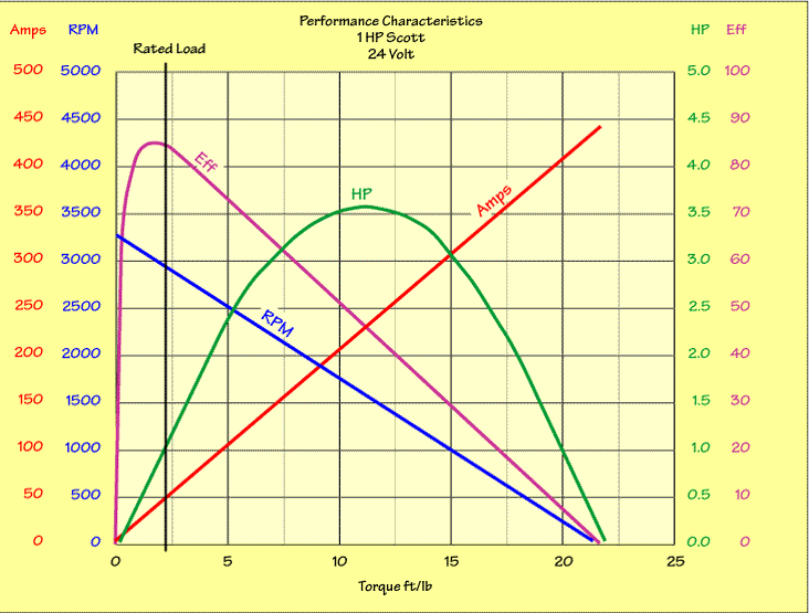

I was puzzled at first by cnh1995 comments, as, depending on load, DC shunt motor will run at any speed from stall to free run. But now I notice he is talking about the "on load" speed being nearly the free running speed. So I thought this graph might be of interest to Rounak.
Presumably the "on load" operating point is normally at the peak efficiency (though I'd have thought that in some circumstances one might wish to operate at higher power, at least intermittently.)
So although the no load and "on load" speeds are very close, this is due to the choice made about the operating point - if you choose to operate (for reasons of efficiency) at small load very close to the free running speed, then obviously there is no difference! But generally the speed is inversely proportional to load.
View attachment 82473 Presumably the "on load" operating point is normally at the peak efficiency (though I'd have thought that in some circumstances one might wish to operate at higher power, at least intermittently.)

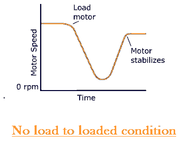

I haven't worked much with dc shunt motor practically .Maybe you could point me in the right direction. Here's what I have understood about dc shunt motor. Suppose the motor is free running with armature current 2A and suddenly mechanical load is applied. Speed will reduce due to opposing load torque, reducing back emf. Now armature current will increase to say 6A and thus torque will increase, increasing the speed and back emf.Meanwhile the current will start decreasing with increase in speed. At a point where running torque of motor becomes equal to the load torque, motor will stabilize at that speed. The new armature current will be say 3A(greater than free running current) which will cancel the load torque. So yes, speed reduces with the load. Is my understanding right so far?
That seems right to me.
My only quibble would be about the motor slowing then speeding up. If a new constant load is applied, then there will be a new point of equilibrium and the motor will slow to the speed of that equilibrium point, with lower back emf, higher current and higher torque. I see no reason why the motor should slow below that new equilibrium speed and then speed up again. As the motor starts to slow, the decrease in back emf is immediate and so then is the increase in current and torque to counter the load.
If there is a temporary underspeed, I think this must be due to the inertia of some real loads. If, instead of applying a friction brake to the motor as might be done in a dynamometer test, you changed gear so that a mass had to accelerate, then you are not applying a constant load and the strange speed load graph shown for example here at http://electrical4u.com/shunt-wound-dc-motor-dc-shunt-motor/
is really showing the variation in load as this inertial load accelerates to the new equilibrium speed.

That's the graph I have in my textbook.Yes,you are right.That inertia point didn't occur to me. Thanks..
