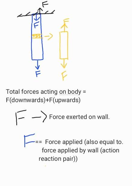

The discussion revolves around the concept of longitudinal stress in a rod subjected to forces applied at both ends. Participants are exploring the relationship between external forces and internal stress, specifically questioning why the stress is defined as F/A rather than 2F/A when forces are applied at both ends of the rod.

  • #32
Orodruin said:
Please show your attempt.
  • #33
It is unclear from your diagram what forces are from the wall and what is the internal tension force. All forces have the same size F, but that comes later from the equilibrium equations. You should be calling the tension force something else, like T. I also suggest that you make the FBD of the part of the rod below some mid-point of the rod so that you have the internal force T rather than the force from the wall on the rod.
  • #34
The top blue and black arrows are reversed.
The force exerted by the bar on the wall (black arrow) is pulling on the wall rather than pushing in.
  • #35
Can you please show me the corrected version?
