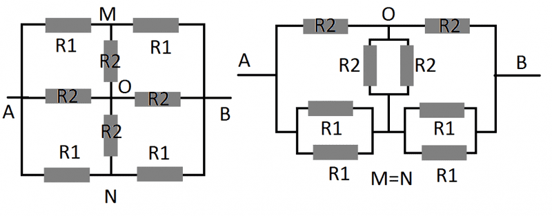

Given an electric circuit, with resistors R1 and R2, find the equivalent resistance R.
Data: R1 = √2.R2
Points M and N have the same electric potential so they can be connected with a conductor and this way we get the second circuit.
Two circuit diagrams side by side: left, a bridge network of resistors labelled R1 and R2 with nodes M, N, O, A and B; right, the same network with M and N joined by a wire, labelled M=N.

In terms of what? I know i can solve the parallel ones below, however that won't solve it. There should be a way to proof that M and N are also equal to O.

It's symmetrical along MO, NO but that doesn't help us much.
Temporarily remove the two vertical R2's. What are the potentials at M,N,O?

On the upper side we will have a resistor with √2R2, but on the down side R2/√2. So they will be different.

Really? What was your argument for M and N having the same potential in your first post?

Equal amounts of charge will flow through the upper or downer R1, and since the resistance is equal the voltage will be too. However I don't understand why the points O and M or N will have the same potential as the resistance along the path is different.

The potentials at M,N, and O are due to the voltage dividers comprised of the resistances in their branches. Here's the situation:
Circuit schematic with terminals A and B connected by three parallel branches. The top and bottom branches each have two R1 resistors with a node labelled M and N between them; the middle branch has two R2 resistors with a node labelled O between them.
All three branches have the same potential difference across them (whatever you imagine to be placed across terminals AB). All three branches have the same resistance ratios...
