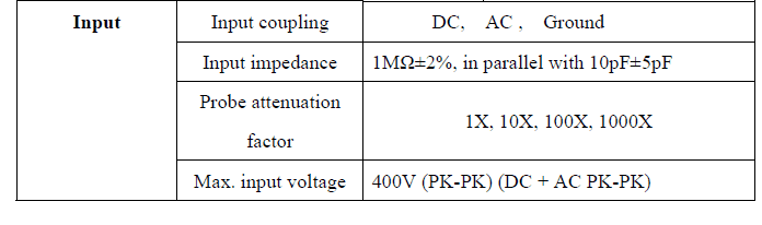

I assume the 10X setting to be the most useful with audio work. Comments??
My oscilloscope has 1M ohm input impedance when set at 10X as stated above.
What is the likely impedance at 1X ?
The manual indicates the above chart is based on the probe being set at 10X. As I am dealing with DC voltages more that 400 VDC (<400 VDC to <= 700 VDC) I assume I need a 100X probe to measure vacuum tube plate conditions that exceed 400 VDC. Yes?
can you scan and post that ?
I'm from old days
some scopes were 50 Ω in
most were 1 meg and a few pf as your chart says
since the 1X-10X switch was in the probe, the scope stayed 1 meg but there was 9 more meg in the probe
and that's why the probe had a trimmer cap to adjust out the pfs from 'scope and probe's coaxial cable.
By the time i got old, the 'scope acquired another ring on its BNC connector through which the probe apprised the 'scope of whether it was selected for 1X or 10X, and the 'scope's internal microcomputer adjusted the numbers on the screen to match. .
Now scopes have a computer menu so complex that i need to have it interpreted by young people.
So I think
your scope is 1 meg on X1 and the probe makes it 10 meg on X10
and the max voltage is 400 at the 'scope input
and
the manual that comes with your probe will tell how for much voltage the probe remains safe... when selected to 10X it divides that voltage by 10 before handing it to 'scope, but i doubt it's good for 4kv.

450 volts at any instant with the supplied 10X probe set for 10X
i didnt see anyplace a specified max for probe set to X1
... tech writers should have included that
one of those things we find the hard way.
Myself I'd buy one of those X100 probes for tube work..
