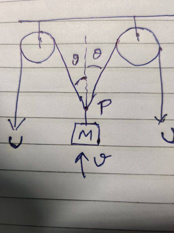

Two similar fixed pulleys with the arrangement as shown in diagram have the vertical string ends moving down at U m/s. If the string over pulley is inelastic then what would be the speed of mass M at any given instant of time?
Resolve velocity U in vertical and horizontal components

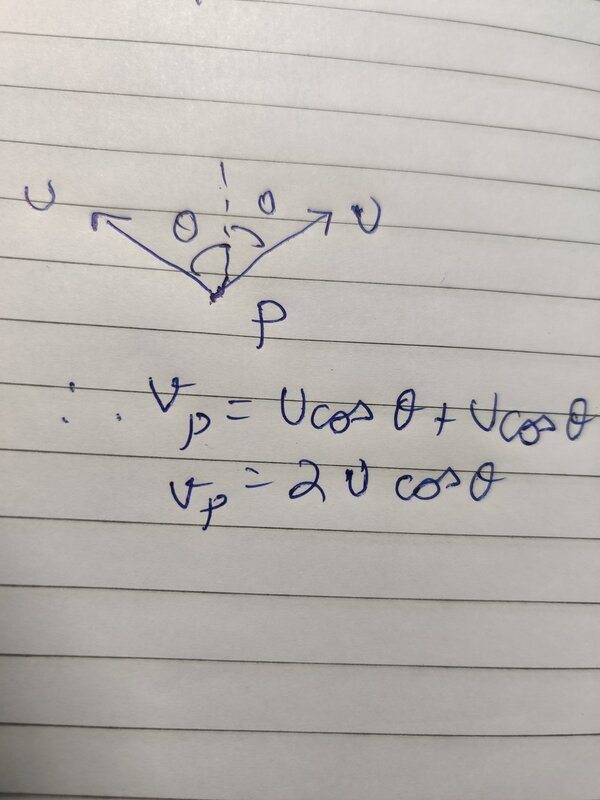

The way I tried to solve it is by using following reasoning.
The inclined part of the string will each have a speed of U m/s. So the point P just above mass M where the inclined strings meet is being moved up by each inclined string at ##U \cos {\theta} ##. Therefore, the speed of the point P is ##2U \cos {\theta} ##. This is not the correct answer, which is given as ##\dfrac {U} {\cos {\theta}} ##. Why is my reasoning not correct?
My attempt is as in screenshot below.
Nearly as I can tell, your math approach is correct (U cos theta) but part of your reasoning is flawed. The "2" is a misunderstanding on your part. The system is mirror symmetrical about a vertical line through P and since you are give U, it is irrelevant that it's happening on both sides. You're getting distracted by an unconscious calculation of FORCE, which has nothing to do with the actual question.
So ... I get U cos theta. Who says it is otherwise?

I thought point P would move with a resultant velocity of the two velocities from incline strings acting at point P.
vcsharp2003 said:
That is the answer given.
Yes, I got that. By WHOM? The book? Well, books sometimes give the wrong answer. If it were your prof on a blackboard it could be that he just made a trivial mistake.
Yes, I understand that and as I explained you are wrong and you are wrong for the reason that I gave.

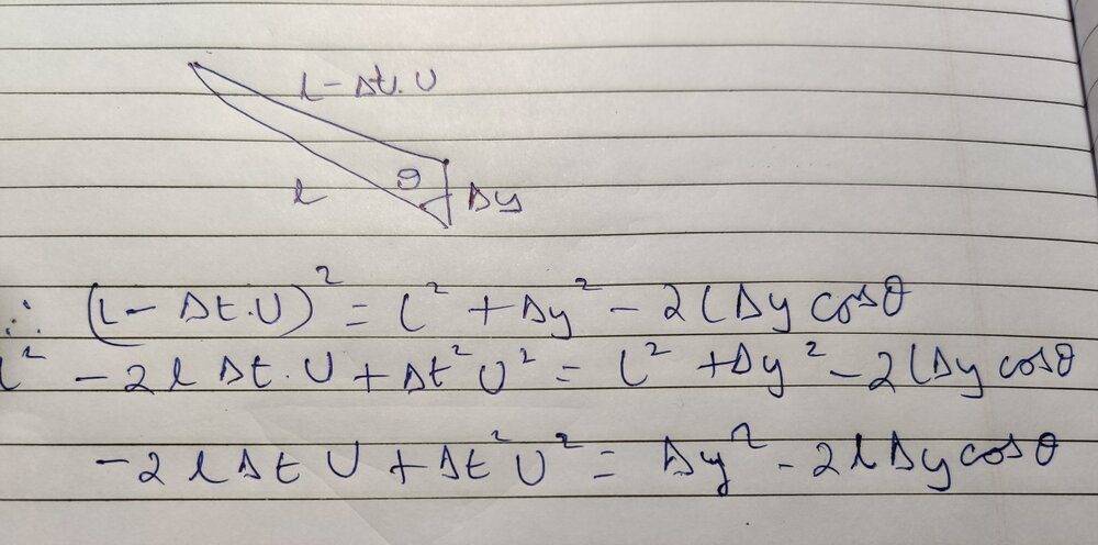

This is what I get by applying the cosine rule.

Another approach I tried is by using derivatives as shown in screenshot below. The length c is constant since it doesn't charge with time.
If I use the ##\triangle {t}## approach, I don't end up with an appropriate equation.

One of my friends said that ## v \cos {\theta} = U## and then ## v = \dfrac {U} {\cos {\theta}}## but it doesn't make sense to me.
Your friend is correct. The instantaneous rate at which the joint just above M approaches a pulley is ##v\cos(\theta)##. This must equal the rate at which the string passes over the pulley.
It helps to consider an extreme case. As ##\theta## approaches ##\pi/2##, what happens to the relative values of u and v?

Is this because we are breaking velocity of P into two perpendicular components, one of which is along the inclined string?
If I use derivatives to solve this question as in post#9 then also I get the same answer that you have mentioned.
It's not a result of analysing it in any particular way. It is true via any valid analysis. But certainly analysing that way helps to make it evident.

Hi @vcsharp2003. I suspect the root of your problem is understanding why ‘v=ucosθ’ is wrong. Maybe this will help.
Crude diagram of left side:
A.B
...P​
P = moving point (P moves vertically upwards.with speed v)
A = top of pulley (a fixed point) Approximate AP to a straight line.
B = a fixed point above P and level with A, to give a right-triangle
θ = ∠APB
AP is the sloping section of the string.
AP gets shorter at a rate equal to u. But AP also rotates about A.
If AP didn't rotate about A, then ucosθ would be the vertical component of P’s velocity – but then P couldn’t rise purely vertically and the left and right strings couldn't remain joined.
We could say something like:
v = ucosθ + {some expression to allow for the rotation of AP about A}
but that would be a clumsy way to find v.
