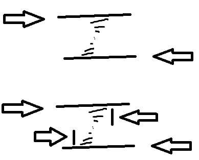

  • #40
A.T. said:
Consider the rigid body analogy:
If you push a block along the floor at constant speed against friction, you will also have a horizontal gradient of compressive stresses within that block. Each slice of the block has to transmit the force to counter the friction of the block part in front of the slice. The further forward you go, the less friction in front you have left.
You mean like this?

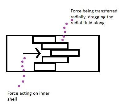

  • #41
boneh3ad said:
If there was no pressure drop, then there would be no force pushing the fluid to the right against viscosity, and the flow would stop.
I'm talking about within the pipe, not between the inside of the pipe and the outside of the pipe at the opening.I can understand the pressure being lower at point D. But why is it getting lower from A to B to C?
  • #42
Some force must keep the fluid in section A-B moving despite the viscous friction with the walls. That's the pressure drop from A to B.
Some force must keep the fluid in section B-C moving despite the viscous friction with the walls. That's the pressure drop from B to C.
Some force must keep the fluid in section C-D moving despite the viscous friction with the walls. That's the pressure drop from C to D.
In the absence of a free body diagram for the fluid in section B-C [for instance], can you at least enumerate the external forces (and momentum flows) acting on the fluid in that section?

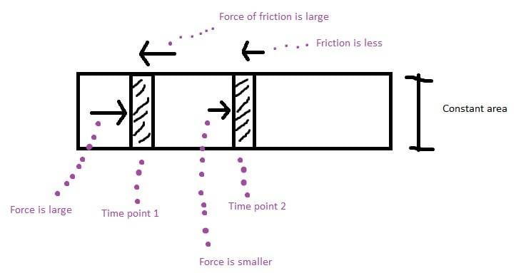

Chestermiller said:
To get an idea of viscous friction, think extreme cases like very viscous fluids like molasses, pancake syrup, and corn syrup. Imagine that you have the fluid contained between two horizontal parallel plates, and you are trying to slide the top plate to the right at constant speed. You need to exert a force on the upper plate to the right and a force on the lower plate to the left to hold it in place. OK so far?
When you say "hold it in place", what do you mean?
  • #58
seratia said:
That makes sense. Someone else in this thread also told me something like this actually, which I forgot about. This is the best example so far. So the middle of the book has half the pressure?
Yes.
I think I understand - so the fluids pressure stays proportional to how much fluid it has in front of it?! If so, that makes total sense!
Only if the exit is at zero pressure. What you really want to look at the the difference in pressure between two locations along the pipe axis; like your example of full pressure at the back, and half the pressure at the middle. This is proportional to the "frictional" force at the pipe wall acting on the fluid between the two locations.
But I wouldn't call that "loss due to friction".
But that is exactly what it is: loss in pressure between two locations due to viscous friction at the wall.
Don't allow it to move.
  • #59
It seems to me that you are viewing force as some kind of momentum, reducing as it encounters friction along its journey.
Like this?
  • #60
This makes no sense to me. A force is just a force.
This makes no sense to me either.
