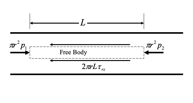

Since you are so focused with regard to forces, have you drawn a free body diagram showing the forces acting on the plug of fluid between r=0 and arbitrary radius r. Or do you feel that you have advanced to the point where you no longer need to use free body diagrams?
Free-body diagram of a cylindrical fluid element in a pipe of length L, with pressure forces pi r^2 p1 and pi r^2 p2 on the ends and shear force 2 pi r L tau_rz along the sides.
Force Balance on Free Body:
$$\pi r^2p_1-\pi r^2p_2-2\pi rL\tau_{rz}=0$$or
$$\tau_{rz}=\frac{(p_1-p_2)}{L}\frac{r}{2}$$
where ##\tau_{rz}## is the viscous shear stress at radial location r
  • Free-body diagram of a cylindrical fluid element in a pipe of length L, with pressure forces pi r^2 p1 and pi r^2 p2 on the ends and shear force 2 pi r L tau_rz along the sides.

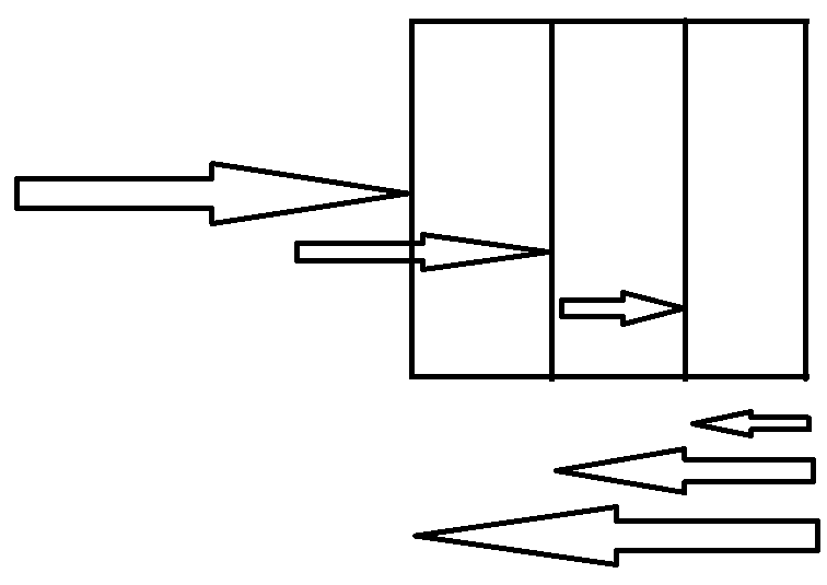

Now to relate this all back to the original question. BvU cited "momentum transport in the transverse direction" as the reason for pressure loss along the cylinder. I take this to mean the parabolic flow, where the center fluid slides against the radial fluids and cause them to flow, although with less velocity as the distance from the center increases. Basically, like a deck of cards being pushed at the top, causing the deck to go from vertical to sideways stacked. So I have two questions:
(A) The above model assumes only the center of the fluid is being pushed, and that the radial parts are all just reactive and move due to friction. Is that really true or just an assumption?
(B) Momentum transport - so basically the center fluid loses momentum due to sliding past radial fluid as it makes its journey through the cylinder. (a) Momentum implies velocity. But as we know, flow rate is continuous along the cylinder, meaning velocity is the same (assuming the cylinder diameter is constant). So I'm confused. The center flowing fluid doesn't slow down. So how is it losing momentum?
I think the model assumes everything has settled down to a steady state and no one is 'pushing' any particular part of the fluid. The pressures and flows are just the result of what is happening higher upstream. I see many parallels here like "How does a resistor in a circuit know how much current to let through?" and (more complex) "How can you work out how an amplifier with feedback makes the gain what it is?". It is not intuitive to take the steady state as the starter for working things out - but it works.
Who says only the center fluid is being pushed? The pressure is distributed uniformly over the entire cross section, so all the fluid is being pushed by the pressure gradient.
The fluid in any shell is dragged backward by the fluid in outer shells and is dragged forward by fluid in inner shells.
The center flowing fluid is dragged backward by fluid in the shell right next door.
Sometimes the term radial transport of axial momentum is used to describe the frictional shear stress. On a molecular level, this makes sense because momentum is exchanged by collisions of molecules (and exchange of molecules) between shells. At the continuum level, this translates into a shear stress.

Actually what I drew in the diagram was a plug of fluid of any arbitrary radius (not a shell). And the diagram shows that the pressure forces at the end of the plug are exactly balanced by the viscous shear force on the surface of the plug. So there is no net force on the plug. However, the viscous shear stress force has to increase with radius of the plug because the plug is larger, and thus the pressure forces are larger.
This all happens because the fluid "sticks" at the wall, and the axial fluid velocity is zero at the wall. So the outer shells of fluid act to try to slow down the inner shells of fluid, and the inner shells of fluid act to try to speed up the outer shells of fluid. This is like your deck of cards in which you push on the edge of the deck, but the cards on the very top and very bottom of the deck are not allowed to move.
