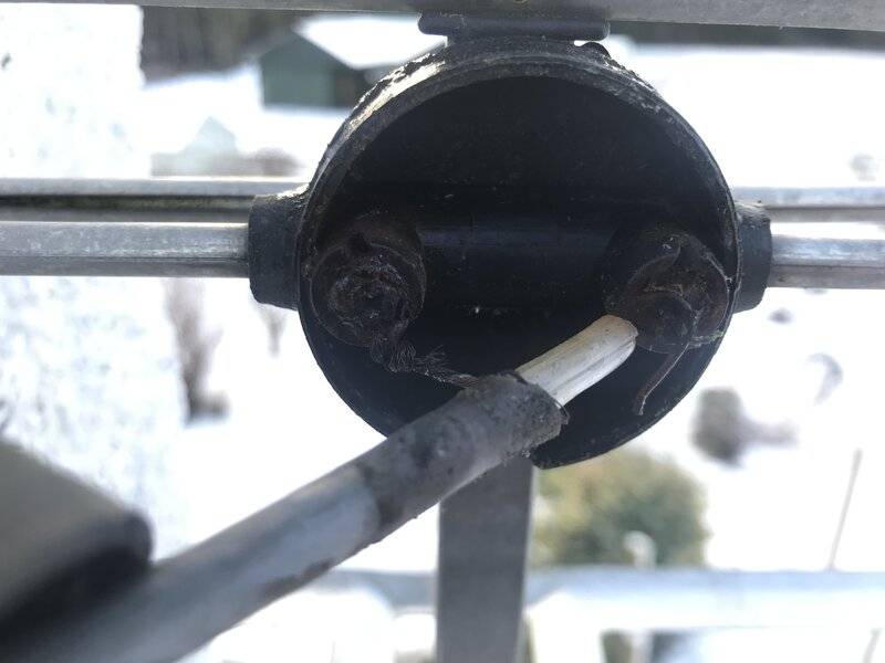

How does a wiggly PCB track convert balanced -> unbalanced, and match impedance?
It’s this type, commonly fitted to UHF Yagis for TV signals:
Online searches, including a reverse image one of the above, haven’t returned any accounts of how it’s designed.
A folded dipole in a Yagi setup apparently has an impedance of 10-40 ohm. The signal must pass to 75 ohm coax. So there must be a step-up impedance match, and a bal-un transformation.
Someone knowledgable on another forum suggested the wiggly track is a delay line, to bring the two ends of the balanced signal in phase to pass down the coax centre conductor.
It is a delay line as you suggest, and doubles the voltage applied to the antenna terminals. In this way it provides an impedance step up of 4, so a 75 Ohm cable is match to a 300 Ohm folded dipole. The two antenna terminals are fed with equal and opposite voltages, so achieving the action of a voltage balun. There is a more commonly seen version of this balun using a piece of coaxial cable half a wavelength long.

Does a folded dipole not have a reduced impedance when installed in a Yagi? Here’s what sparked the question:
The cheap aerial (made in 1984) installed at my house, causing surprisingly minor glitching on one mux only. As you see, no balun. Is it really the case, for the sake of a cheaply-printed PCB, that a 300 ohm dipole is connected straight to 75 ohm coax?
What would an equivalent circuit of the PCB balun look like? I’m not quite getting how the copper track relates to more familiar diagrams of voltage and current baluns.

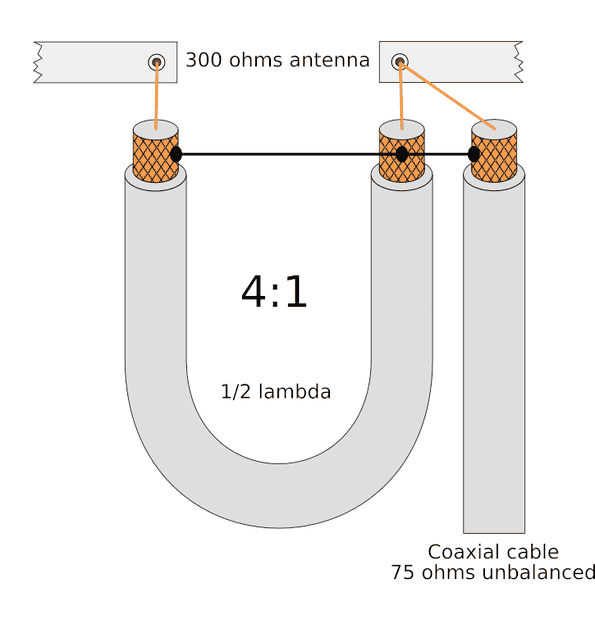

This is a picture I found of the same thing using half a wavelength of coaxial cable. If the parasites are closely spaced, then the feedpoint resistance will drop, but for wide band antennas, such as for television, wide spacings are used. The antenna manufacturers are not too concerned with impedance mismatch as it does not reduce gain very much. If no balun is used, the pattern can be distorted a little. But if the cable proceeds from the dipole at right angles the effects are small, especially as the cable is long.
Ah, I recognise that from trying to build my own DTV Yagi, although I was just following instructions from a Yagi calculator.
What I was looking for was an equivalent circuit depicting that PCB balun as discrete components, rather like the lumped element model of transmission lines. Your reply (post #2) makes perfect sense, but I don’t yet see how it relates to fundamentals.
For example, it’s not immediately obvious that a doubling of voltage means a quadrupling of impedance, unless we’re talking transformer action, or relating impedance to ##V^2## with constant power.
If the former, are we looking at an autotransformer balun? Is the length of that wiggly track a half wavelength, to bring the two dipole terminals in phase?
Look at it this way: Take a snapshot in time when the voltage at the node where the two coax cables join is at peak voltage. The opposite end of the half wave section will be 180° out of phase. So the voltage between the ends of the half wave section are double the voltage at the node. You have to quadruple the impedance. If you didn't you would be picking up that power out of nowhere. Or losing it, depending on which direction power flow is.

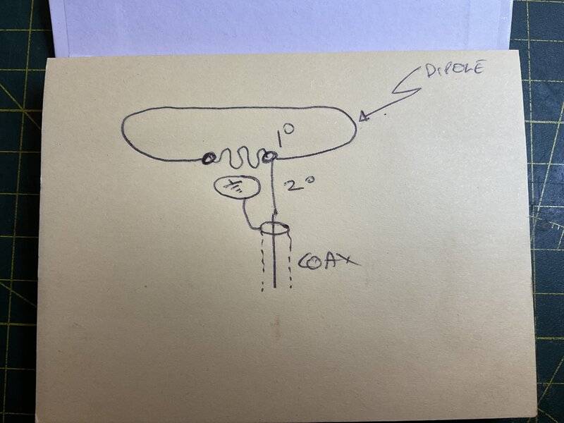

As for the bal -> un conversion, am I looking for a transformer?
Is the primary formed by the PCB track, and the secondary by the ground plane as in the drawing? It looks like some form of autotransformer, given the primary and secondary are common between dipole and coax on the right-hand side.
In some small way, it looks a bit like a final distribution mains transformer, where the incoming line is floating with respect to earth/ground (balanced above and below), and the secondary is tied on one side to earth/ground, forming the unbalanced (Live/Neutral) side. If that is the case, that would be nice.
This particular balun is not a transformer but it uses a half-wave transmission line. The PCB ground plane is connected to the coaxial outer and forms one conductor of the half wave transmission line. The arms of the dipole are fed with +V and -V, giving a total of 2V. For constant power this gives R proportional to V^2 as you mention, giving 300 Ohms.

I see, so it’s this effect that does both the impedance and the bal -> un transformations. Very clever and deceptively simple. Does the half-wavelength distance constitute the ‘delay line’, or is that a different effect?
I take it the ground plane has to remain isolated, or the coax outer shield would become part of the dipole.

To make that a 4:1 balun the PCB etched transmission line will need to have an impedance equal to the coaxial line, and be electrically half a wavelength long.
Since the folded PCB line should be physically short, it needs the lowest velocity factor, that suggests it needs a high capacitance, since, vf = 1/√LC. I would expect the thinnest available PCB, with a ground plane to minimise vf, by maximising C.
A broadband balun could pass the entire UHF band, but here we have a narrowband half-wave line balun, said to be for about f=640 MHz, λ=470 mm ; λ/2 = 235 mm. Even with a low vf, that line does not look long enough to me. Maybe it is designed to operate at higher UHF, shorter wavelengths?

For a half wave balun it seems to me that the characteristic impedance will not be important, because the same impedance appears at both ends of any half wave line. It looks to me also that it is very short, so maybe it is for higher channel numbers as you mention.
