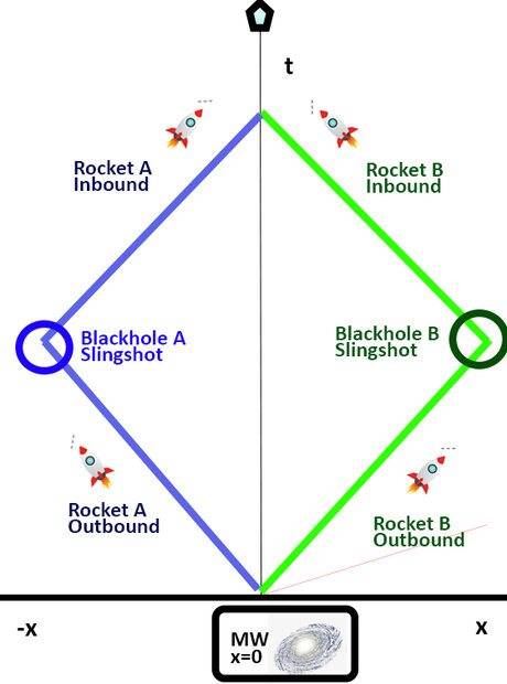

I'm struggling to wrap my head around the twin paradox in special relativity especially when dealing with multiple vectors.
In my thought experiment say I have a set of twins. Both set out in opposite directions and intend to sling shot around two different black holes(luckily equidistant from the milky way) and rendezvous back where they started.
As they accelerate away towards 99.999%C(in perfectly opposite directions) observers in the Milkyway will notice that the occupants on the ship will almost freeze in time and will come back having aged slower than the Milkwayers.
My question is this...how will the two ship's clocks compare for
  1. The outbound journey?
  2. The Inbound Journey?
  3. at the rendezvous location?
I'm also assuming their journey's are a perfect symmetry of each other(?)
If they end up having a synchronized clock at the end does this also reflect the experience of massless particles as they bound around the entire universe(like photons?) e.g. an emitted photon could in theory bounce off an event horizon and instantly find itself energizing the same electron orbit that emitted it? Surely this would also make us holograms!
You need to look up the relativity of simultaneity, which is a really important part of the theory[1] and gets little air time. In short, what "during" each leg of the trip means is different for the different legs of the journey, and a naive time dilation analysis doesn't account for the bits of the other twins' experiences that aren't "during" any part of the trip (at least, not according to that naive analysis).
Massless particles travel along null worldlines and time isn't defined for them, so you can't describe their experience.[1] In deference to Orodruin, I will say "a really important part of the theory if you start with length contraction and time dilation instead of Minkowski geometry".
If that is the case (not sure why you have question marks after it, you are specifying the scenario and if you say the two journeys are symmetric, then they are), then this...
...will also be true.

PeterDonis said:
If that is the case (not sure why you have question marks after it, you are specifying the scenario and if you say the two journeys are symmetric, then they are), then this......will also be true.I have no idea where you're getting this from, but it's (a) unfounded and erroneous speculation, and (b) irrelevant to the scenario you describe in the OP of this thread. I would advise dropping this line of thought entirely.
Thanks Peter, You are right that last statement was erroneous and I was loosely trying to reconcile special relativity with quantum physics. If the two travellers have perfectly symmetrical journeys then in theory they could travel billions of light years apart but on the rendezvous still be in perfect sync with each other?
When they return, yes, they will be in sync. But during the journey most notions of simultaneity (pretty much all except the stay-at-home's notion, in fact) will say they are out of sync.
If their journeys are symmetric, which one would you expect to younger at the end?
