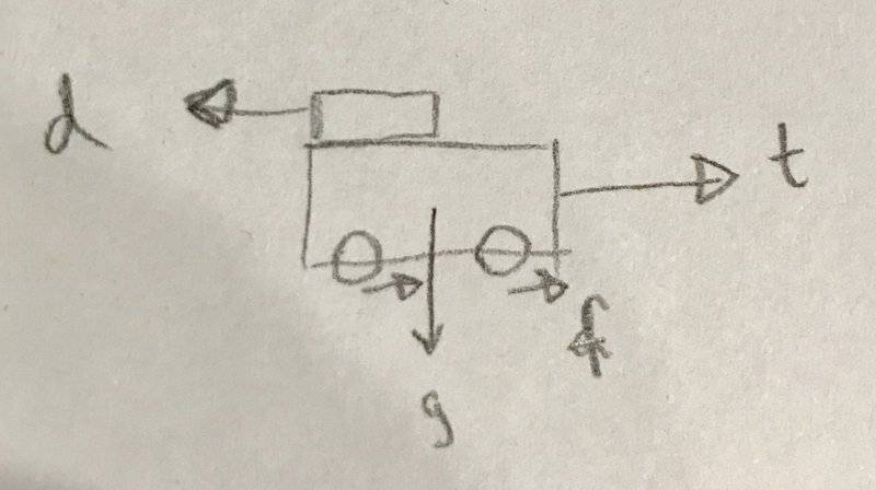

A model? Like a vector drawing or something like that? I am not a physicist but I am guessing something like this:
In physics, a "model" or "mathematical model" is a set of formulas or equations that describe a phenomenon. One simple model for friction is that it is proportional to the perpendicular force between an object and a surface. The perpendicular force is referred to as the "normal" force. The constant of proportionality is the coefficient of kinetic friction. The greek letter mu (##\mu##) is conventionally used to denote the coefficient of friction. The coefficient of friction needs to be measured.
$$ F_{friction} = \mu F_{normal} $$

No, in this context a "model" is some reasonably accurate quantitative description of the friction forces. These are the forces that will slow down and eventually stop the car, so you must have some idea what they are to calculate how far the car goes before it stops.
I say, as long as the force exerted by the rocket motor is greater than that of frictional force, the car won't stop. It keeps moving. So the time period taken for car to stop in that case is 'Infinite'. Once the force gets lesser than that of friction force, the car can stop at some point and yes, its time period can be calculated in this case.

You have 2 resistances: rolling resistance ##F_R## and aerodynamic drag ##F_D##. Aerodynamic drag should be the greatest by far.To get the acceleration, it is simply:
$$\sum F = ma$$
$$F - F_R - F_D = ma$$
$$a = \frac{F - F_R - F_D}{m}$$
Where ##F## is the force produced by your rocket.
During the travel time, these forces will vary, so the acceleration will also vary. For the rocket, I'm not an expert on these engines so I can only guess on the force output versus time ##F(t)## equation to define it. Maybe other can chime in. But let's imagine that it is constant for the full 1 s.
The rolling resistance is mathematically similar to friction, so ##F_R = C_{rr} F_N##, where ##C_{rr}## is the coefficient of rolling resistance and ##F_N## is the normal force (i.e. the vehicle weight ##mg## in our case).
The aerodynamic drag is ##F_D = \frac{1}{2}\rho C_D A_f v^2## where ##\rho## is the air density (1.23 kg/m³), ##C_D## is the drag coefficient and ##A_f## is the frontal area of the vehicle and v is the speed of the vehicle. As you can see, as the vehicle increase in speed, the drag increases, thus your acceleration will get smaller as it travels.
To calculate the velocity after 1 s of travel (when the rocket pushes the vehicle):
$$dv = adt$$
$$dv = \frac{F - C_{rr} F_N - \frac{1}{2}\rho C_D A_f v^2}{m}dt$$
Which can be rewritten as:
$$\frac{dv}{\frac{F}{m} - C_{rr} g - \frac{\rho C_D A_f}{2m}v^2} = dt$$
Simplified as:
$$-\frac{1}{B}\frac{dv}{v^2 - C^2} = dt$$
or
$$t = -\frac{1}{B}\int_0^{v_f}{\frac{dv}{v^2 - C^2}}$$
Where:
##A = \frac{F}{m} - C_{rr} g##;
##B = \frac{\rho C_D A_f}{2m}##;
##C = \sqrt{\frac{A}{B}}##.
The solution of the previous integral is:
$$t = -\frac{1}{2CB}\ln\left|\frac{v_f-C}{v_f+C}\right|$$
You can find ##v_f## for ##t=1## by trial and error. Check that ##a(v_f) > 0##. If it is not, then calculate the speed ##v_f## that will give you ##a = 0## and find times ##t'## that it will take to reach that speed with the previous equation. Then the vehicle will be going at constant speed ##v_f##. ##v_f## when ##a=0## is known as the terminal velocity of your vehicle.
After you found ##v_f## (and ##t'## if that was the case), you can find the distance traveled with:
$$dx = \frac{v}{a}dv$$
$$dx = \frac{v}{\frac{F}{m} - C_{rr} g - \frac{\rho C_D A_f}{2m}v^2}dv$$
Simplified as:
$$dx = \frac{v}{-Bv^2+ A}dv$$
or
$$x = \int_{v_0}^{v_f}{\frac{v}{-Bv^2+ A}dv}$$
The solution to this integral (see 17 here) is:
$$x = \frac{\ln\left|-Bv_f^2+A\right|}{-2B} - \frac{\ln\left|-Bv_0^2+A\right|}{-2B}$$
Where ##v_f## was found previously and ##v_0## would be the initial velocity, i.e. 0.
If there was a ##t'## found previously, the vehicle will travel from ##t'## to ##t## at constant speed ##v_f##, thus you must add ##v_f (t- t')## to ##x## to find the total distance traveled during the full time ##t##.
The rocket stops
Now your vehicle is going at speed ##v_f## and has traveled a distance ##x## after time ##t=1\ s## (or whatever other time you want). The rocket stops pushing, thus ##F=0## at this point and ##A## is modified to ##A' = - C_{rr} g##. What we want to know is how far will it go before it stops by itself (due to drag and rolling resistance).
We know the initial speed ##v_f## at this point and we know final speed will be 0 when it stops. Thus we can use the same equation as before, but with the new values:
$$x' = \frac{\ln\left|-B(0)^2+A'\right|}{-2B} - \frac{\ln\left|-Bv_f^2+A'\right|}{-2B}$$
And the total distance ##d## traveled will be:
$$d = x+x'$$

Yes I understand I need a model for the friction but it's painfully clear that I don't know how to come up with such a model which is why I am asking for help with that since post #19 when jbriggs suggested it and I made my little drawing.
So I know the car will have a force pushing it forward, given by the 12.8N stated by the rocket datasheet?
The force acting against it is friction as defined by u * F(normal).
jackAction thanks for your post.
I would use a stagecoach reference 0.0385 for Crr
and 1.28 flat plate perpendicular to flow and 16 cm2 for my Af.
Great explanation on the integrals. You actually got me interested in them again because your explanation demonstrates how an integral is used to calculate the problem. Of course you simplified and solved them for me which was a great help btw. I was able to follow most of the derivations though. Now what do you mean by "I can find vf at t=1s by trial and error"?
Ok now with vf I can calculate x traveled and then add the next part which is the distance traveled now that F = 0.
