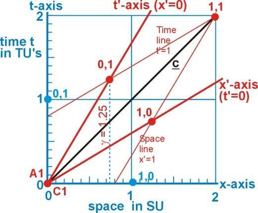

Getting back to steve's original question:
stevmg said:
I was trying to find the relationship between a and [tex]\phi[/tex].
I know that sinh [tex]\phi[/tex] = ct/a and cosh [tex]\phi[/tex] = x/a
Now I have to let the dust settle, have you all agree what I just wrote was correct...
From the above image, you can see that:
[tex]t^2 - x^2 = constant =a^2 = (cdt^2) -dx^2[/tex]
Note that the constant is not necessarily one. The hyperbolic curve is the horizontal version that represents a curve of constant proper time for various relative velocites, rather than using the vertical version you were using before that represents a curve of constant proper disnance.

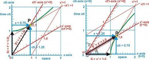

stevmg said:
I was trying to keep a geometric feel for all this so that when I delve into rapidity I could visualize what I was doing.
Also, why is this matrix referred to as a rotation of axes? What is rotated?
If you look at the diagram below:
You can see that the x' axis has been rotated anticlockwise while the t' axis has been rotated clockwise relative to the x and t axes respectively. The amount of rotation of the axes depends on the relative velocity between the F and F' frames. The relative velocity in the above diagram is 0.6c so the proper time t' =1 translates to t=0.8 and the proper distance x' =1 translates to x=0.8. Note that point P = (x',t') = (0,1) remains on the horizontal hyperbola in the left diagram, for all relative velocities and the point P = (x',t') = 1,0) remains on the vertical hyperbola in the right diagram, for all relative velocities.
Diagrams from http://hubpages.com/hub/Minkowski-Diagram

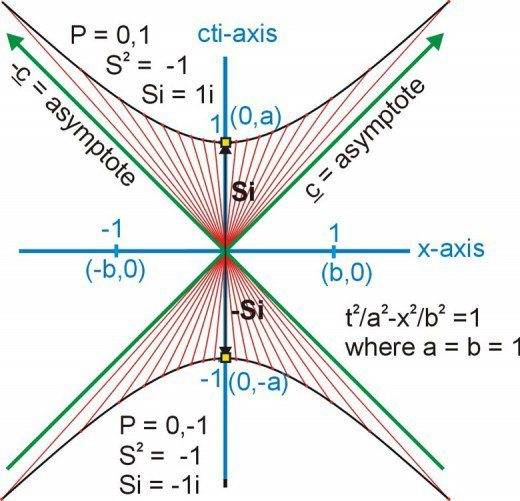

The vertical hyperbolas you posted - are they the usual hyperbolas associated with these kinds of problems. Surely, the asymptotic light cone is. Which way do we go? Up and down, or sideways? Don't make fun of me, now, and you all know what I mean.

The hyperbolas in the graphs are of the form x2 - y2 = a2. The foci of these hyperbolas are along the abscissa and these hyperbolas are symmetric. The positive x-intercept is at (a, 0). The coordinates of the foci are irrelevant for this discussion. By the Einstein-Minkowski 4-space equations:
x2 - c2t2 = x'2 - c2t'2 or x2 - c2t2 = a constant, say a2
This matches the equation in this textbook literally as is (if you use x for and ct for y).

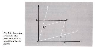

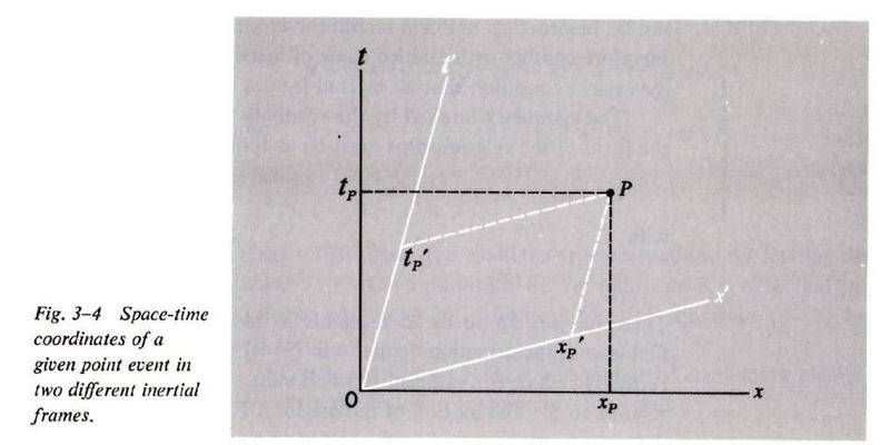

kev -
I cannot make heads, tails, x's, y's, t's or anything out of those diagrams.
I know Galilean transformations are "shear." That is - like a box squished to the left or right with non-perpendicular axes. Is that a form of rotation in itself? Or does the abscissa and ordinate axes remain perpendicular under Galilean transformations?
Is it the Lorentzian transformations that twist the ordinate axis off perpendicular to the x-axis?
This thumbnail (I still haven't figured out how to get a full sized picture uploaded) is what I am talking about. In this case, the y-axis is twisted or rotated off perpendicular.
If it were just a Galillean transformation, the y-axis would still be perpendicular but the "world lines" would be off perpendicular...
Am I right?
Remember, step-by-step I learn...

  • #57
kev - I got to the website and saw all those diagrams that the article had. Now, how did you put that into your note? There are numerous diagrams on that website and you only used a couple.
stevmg

stevmg said:
That's why I was looking for the visual or geometric approach so I could better internalize the concepts.
Kev's diagrams pretty much say it all. Perhaps they say too much. Let's just look at the first diagram. You may know a lot of this already, but maybe you'll find it helpful.
The first diagram plots life (space-time life) for inertial (unaccelerated) observer O who starts at the origin and (in his own frame). The t-axis is the blue line going up plots O's life as time ticks by - since there's no change in the x coordinate along this line (and we're suppressing y and z directions), this line shows O not going anywhere, just letting the time tick by. The blue notches along this diagram represent ticks of the clock, each notch a unit of time.
The x-axis is, in this diagram, the events that are simultaneous with t = 0, for Observer O. It's an unusual way of thinking about the x axis, but it's very helpful in space time. Each notch in this axis represents a unit distance. The horizontal blue line drawn at t = 1 represents all the events that are simultaneous with whatever happens at the point (1 0), according to O.
Now look at the steeper red line. This is the space-time path of some OTHER inertial observer, o', travels. O' is inertial too - he travels at a constant velocity hence he cuts out a straight line in space-time. The faster he travels, the more angled his world-line. But the speed of light is a limiting factor, so the angle that possible observers can travel is bounded: namely by lines that represent the speed of light. Often, units are chosen so that light can be represented by lines that lie at 45 degrees to the axis.
Ok - so that steeper red line represents the path of O' - it's HIS time axis, commonly written as his t' axis. But what about HIS x - axis? Well, his x-axis are those events that HE regards as simultaneous. These events appear on the same map - both O and O' are privy to the same events - they just disagree about time and simultaneity. Well, when you follow the Lorentz transformations, it turns out that the x-axis of O' is tilted up - so that it becomes the less tilted of the two red lines. So that red line marked x' axis is the events that observer O thinks happen at the same time as events at t' = 0. You can see that, apart from the origin, O and O' disagree about which events are simultaneous with which. Again, lines drawn parallel to this red line represent lines of simultaneity in the frame of O'.
If we're using units where light travels paths at 45 degrees, then for any frame F, the t axis and the x-axis make the same angle with the 45 degree line - fold the paper along a 45 degree line, and the t-axis and x-axis of a frame get mapped onto each other. Now, the faster something travels, the closer it is to a 45 degree angle - the closer O judges it as getting to the speed of light - and the more its x-axis is tilted over. If you were to imagine continuing the process, the x and t axes collapse onto each other at the speed of light.
This tells us the angles - but we would also like to know how the clocks and lengths of O' work - we would like to draw HIS notches - that is, we want to calibrate his clocks and lengths. What does HE regard as a tick? What does he regard as a unit distance? Well, because of time dilation, and lorentz contraction, the notches that he draws are different from ours. I think kev's second diagram represents the notches as seen by the second observer.
All that drives this is the Lorentz transformations. They're just linear transformations - it's just a matter of matrix multiplication, so, though they're abstract, you're probably more familiar with them than you realize.
As usual, this took longer to say - hope there aren't too many typos...
