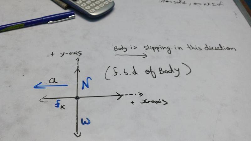

How would you solve this question:
A body slipping on a rough horizontal plane moves with a deceleration of 4m/s^2. What is the coefficient of kinetic friction between the block and plane ?
Please note that this is not a HW question
I am asking this, because i think that in this case you will take -4 = -f(static friction)/m
And thus 4= f(static friction)/m
f(static friction) = μN = μmg
Therefore μ=4/g
In this case we are taking kinetic friction as the reason for accelaration
But kinetic friction resist the relative motion, then what is wrong, if in this case its helping to accelarating
Then how will you explain it at molecular level.
