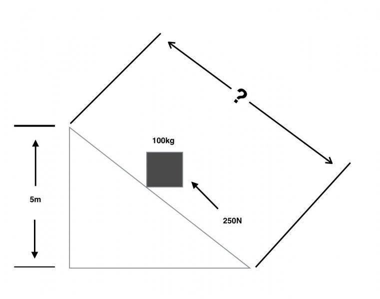

  1. An inclined plane is used to raise a 100 kg box to a height of 5 m. How long must the inclined plane be if a force of 250 N is used to push the box up the inclined plane?
i have search and searched all over google to try to figure this out.. I am not sure if I'm over thinking it or just confused myself even more. I found one equation that I think is correct, but as i was looking at other examples I tried to use this formula and it never worked out like I thought it should. Also, I am always finding examples that have an angle of inclination.. But the formula I think should work is.
[tex]\frac{f}{w}=\frac{h}{l}[/tex]
[tex]\frac{250}{100}=\frac{5}{l}[/tex]
l=2?
cheers
keith

You won't be able to avoid involving either sinθ or cosθ in your calculations.
Can you attach a pic showing the relevant diagram you have drawn for this problem?
You could draw a free body diagram to see what forces are opposing the motion of the box on an incline. For there to be an upward motion, that or those force(s) must be less than the upward force.
i can try to draw pic and post it...
That is where i am confused.. the question isn't giving me an angle of the incline.. so how do i include sinθ or cosθ?
Maybe one of the opposing forces is related to the angle ##\theta## of the incline.
OK. Next show a vector representing the force of gravity on that box. What magnitude would this force have? And its units?
Have you given the slope a name, i.e., a letter?

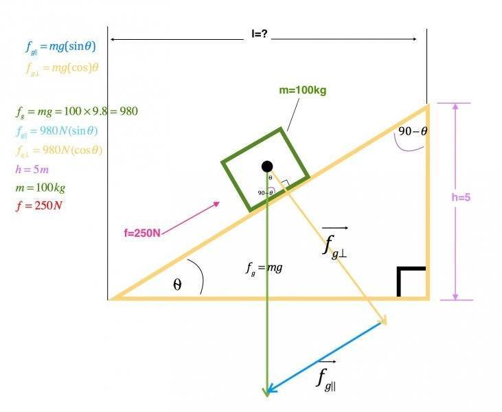

OK, so here is what I put together so far...
So far so good ...
NascentOxygen said:
So far so good ...
I guess this is where I am really stuck. Without a given angel for theta, how to I proceed with my problem?

On your figure you show the pink 250N acting up the slope. You equate this to the blue component of weight acting in the exact opposite direction. You have the equation for that, you called it fg∥.
Thats right, what you find is that if you remove the force at that point, it will decelerate to a stop exactly at the top of the slope.
This d applies regardless of which incline angle you choose ( up to 14.764 °).
Dean Barry
ok so, 250=980(sinθ)
sin(θ)=250/980
θ=sin-1(250/980)
θ=14.77
so if θ=14.77°
then, sin(14.8)=5/h
h=5/sin(14.8)
h=19.57m
Looks right. Note: the length of the slope is not the "l" you show on your figure.
In 99% of the problems of this type you are required to find the slope or θ. In today's problem you don't specifically have to. Going back to your figure, you could have looked at similar triangles: the slope triangle, and the weight triangle. This leads to the equating of ratios (which may be what you copied from something on the net way back near the start).
It would be worthwhile making sure you can see those similar triangles, before leaving this problem.
