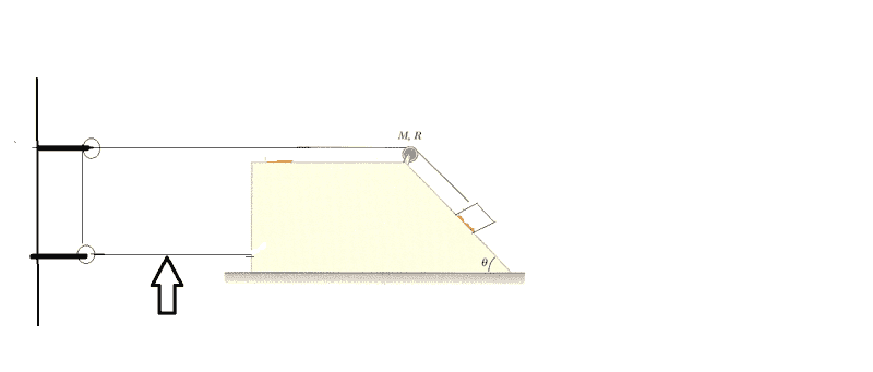

how the wedge is connected with highlighted string?
What does the description that comes with the picture say?
I suspect the string is attached to the small weight at one end, it passes around two pulleys (attached to the wall) and then to the wedge.

It only says if the wedge covers x distance horizontally in right direction,block will cover 2x distance along the wedge.
That confirms Simon Bridge's interpretation. As the wedge moves x distance from the wall, x length of string is pulled through the pulleys at the wall.
At the pulley on top of the wedge, x length of string will have been pulled through by the wall and an additional x length of string will have been moved through by the wedge. A total 2x length of string will thus have moved through that top pulley.

Just to clarify the actual layout:
Yes. A hook, nail or eye on the vertical side of the big block holds one end of the string and the string passes freely around both pulleys (the diagram could have been drawn better!) Simon's answer is obviously correct. What do you not understand about it?

Of course. Assuming nothing tricky is going on, the string attaches to the wedge at one end (with some hook or similar attachment method) and to the small block at the other end. (This is a standard physics problem configuration.)
